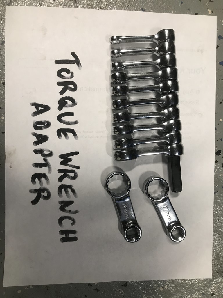

    I'm bored as well trying to torque my front end.
    Didn't fucking know that I had to do a calculated torque conversion when using a Crow's Foot or Torque Wrench Adapter (pictured and labeled again for @V5ioV benefit. LOL)
    Been fcking over torquing stuff for years when using a crows foot.

    Typically an extension sucks up some of the torque. Guess it makes sense that a crows foot adapter multiplys torque. You have a link for the conversion factors?

    This front wheel bearing bolt is a good example: I've been torquing with a crows foot to what I thought was 59 ft-lbs. but with the added length of a 1.25 inch crows foot, I've actually been torquing to 64.
    With a 2" torque adapter, I need to set my torque value to 52 ft-lbs to get the actual torque of 59.
    Damn, learn something new every day.

    Here's a good torque calculator.
    There are a couple of iPhone apps that haven't been updated in a few years and will crash with any current iOS
    Toy4me and Blackout14 like this.

    And, the torque value is different if you use any extension adapter/crows foot at a different angle as well. The torque conversion calculator that I linked allows for that angle.
