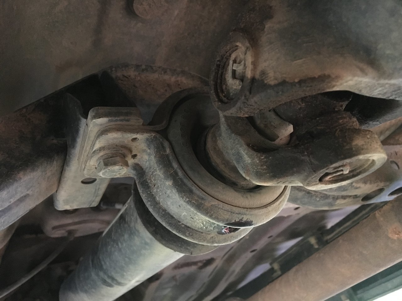

    Hey guys, think the carrier bearing is bad? The DS doesn't look centered at all and I can move it a bunch with my hand
    Saw this when I went to grease my i joints, hoping that would solve the squeaking noise lol

    How much is a bunch in fractions of an inch?

    .25 I'd say or more

    Up to 1/2" is ok.

    Looks dead, or nearly. You'll need to replace it soon either way.
