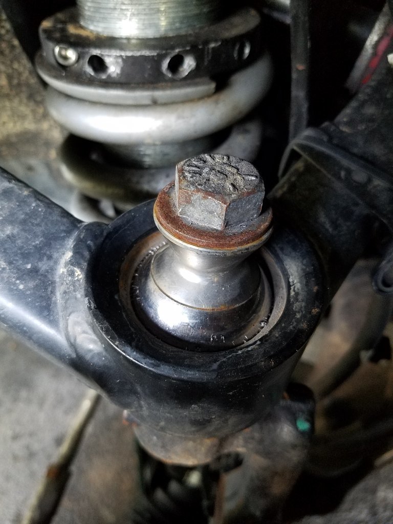

    Is it on both sides Garret?

    No just Driver.

    Typically the only thing you would find around the uniball would be pieces of the PTFE liner as it distintegrates. Metal shavings would indicate that the liner is gone and the ball and race are rubbing against each other. Any slop in it?

    Just checked. No slop. But maybe the ptfe liner is just start to go. I guess I should order new uniballs.

    How many miles on those Garrett? Didn't you just install those last year?
    Possibly covered by warranty?

    How old are they and how often do you lube them? My TC arms are about a year and a half old and look fine.

    I think it's been about 18 months.
