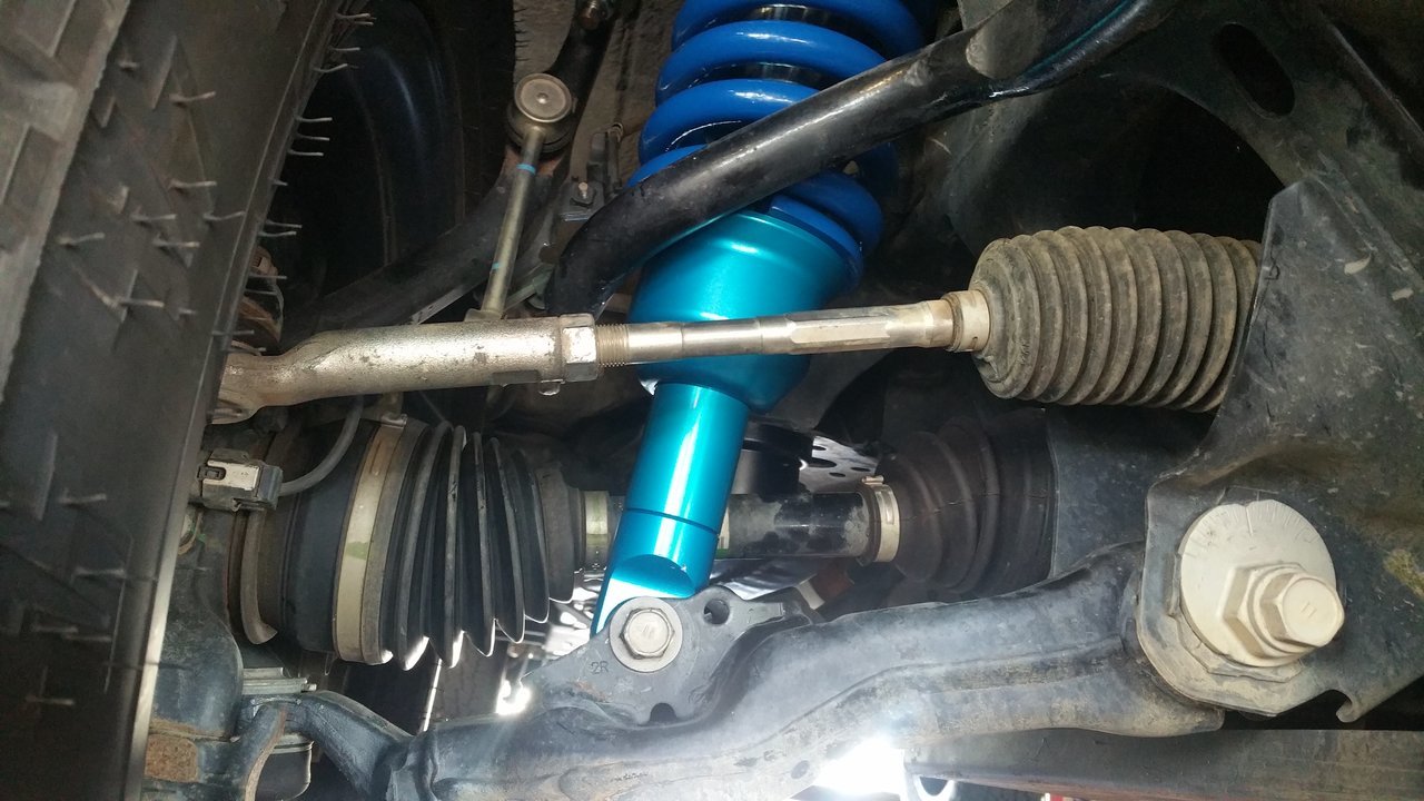

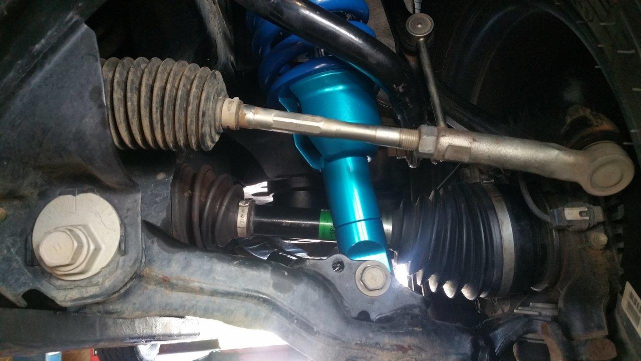

    OK what I've done so far
    Remove new battery put new in. Same
    Remove cb drop kit. Same.
    Remove drivesheft. Same
    Here is the front cv.

    Where does it feel like its coming from? Cv angle looksjust like mine honestly.

    I can't tell. But more in the front. Remove the driveshaft. So can't be that correct? Has to be somewhere in the front?

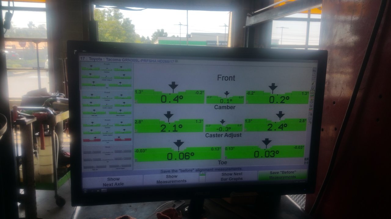

  15. Aug 20, 2017 at 8:01 AM
    diabetiktaco
    diabetiktaco Instalander
    Sep 5, 2016
    #196480
    5,738
    Eric
    New Jersey
    2022 GX460
    I was just going to ask. @Braves95 did you rotate the tires?
  16. Aug 20, 2017 at 8:09 AM
    Braves95
    Braves95 Go Clemson Tigers
    Oct 9, 2016
    #199319
    6,509
    David
    Central PA
    17 MGM TRD Off Road DCSB P&T 6MT
    Fab Fours Bumper Block Heater Dual Exhaust Flow Master Smittybilt 12k Winch Synthetic Rope Bed Mat Roof Rack Puddle Lights 17" Rockstar Wheels NittoTerra Grapplers Power TailGate Lock Tonneau Cover w/lights Mobtown sliders MT Remote Start Tinted Windows Front And Rear Camera BRC Competition Diff Breather Bed Step Weather tech Floor Mats TRD Pro Tail lights TRD MT Shift Knob ARB dual compressor URD short shifter Kings 2.5 OEM W/remote resi. Click adjuster.
    We are doing the alignment right now.
    Blackout14 likes this.
  17. Aug 20, 2017 at 8:34 AM
    Braves95
    Oct 9, 2016
    #199319
    6,509
    David
    Central PA
    I know.
  18. Aug 20, 2017 at 9:00 AM
    Braves95
    Oct 9, 2016
    #199319
    6,509
    David
    Central PA
    Alignment done.
