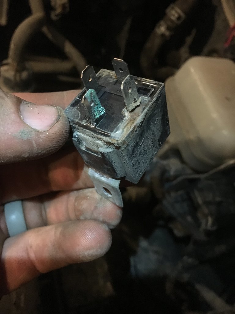

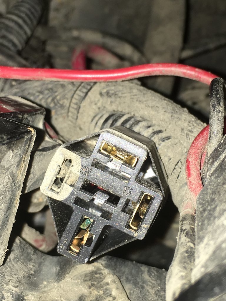

    Ok so yall had problems wiring like a light dont work and you not sure why. I have a problem my ditch lights won't go off and I dont know why.. Switch was never touched for them to go on. Woke up one morning and saw them on, killed the whole blue sea and went to work. Just poking around now trying to figure why they went on and why they won't go off.
  15. Oct 19, 2017 at 7:40 PM
    Chux
    Chux Pura Vida
    Oct 1, 2013
    #113652
    6,234
    NJ beaches
    2013 TRD O/R Beach Buggy
    Click on my Build
    Dirt and water got in :anonymous:
    Dude you nailed it. I started from the switch and worked my way through the harness. Completely unplugged the switch and it remained on. Checked the relay and it looked terrible. Cleaned the terminals but the lights stayed on. I actually found a spare relay I had laying around and plugged in.. bingo bango!

    Maybe seal the connectors with dielectric bulb grease for preventive measure?

    I thought the Blue Sea stuff was supposed to be water proof/resistant?
    Oh, maybe these were what I was thinking of... (started with a B, close enough). :tinfoilhat:
