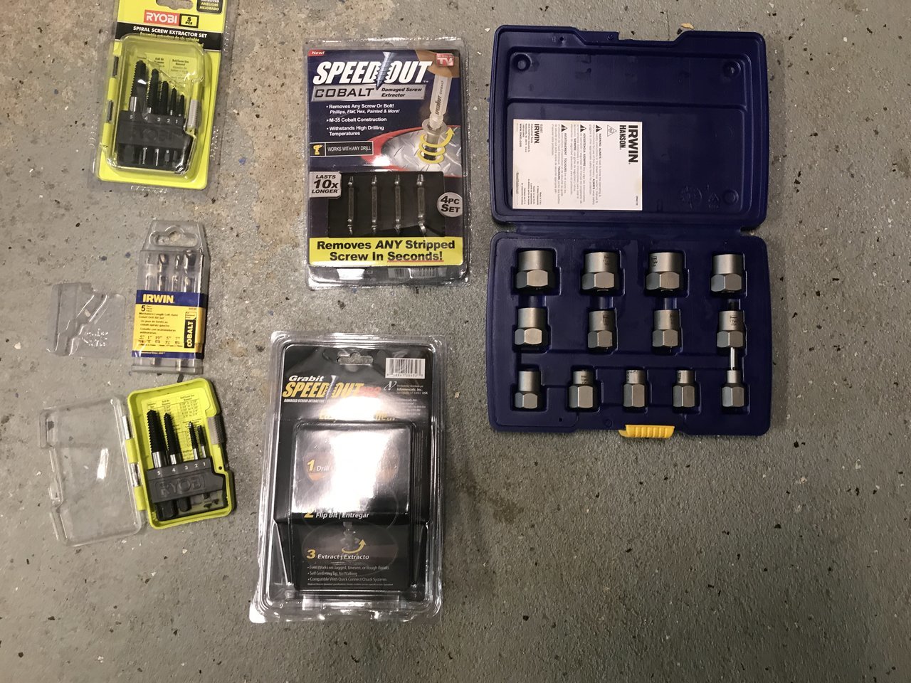

    I started spraying everything today, and will continue to do so until the parts get in. I've learned from the past when I didn't, and the difference can be significant. I recently picked up a MAPP torch, so I am hoping that helps if I need it (I assume I will). I also have a 1/2" electric impact now and a breaker bar. I have a wonder bar, but no larger ones that I know of. There are also a decent array of miscellaneous tools in the garage here in case I don't have something. Often times, there is something here. A few ratcheting wrenches here, but a spotty mix of sizes. Hopefully I have what I need or can do without. I do have a large and small jack as well as large and small stands. Should be good there. Between what I have and what is here, I should be okay. But I wouldn't be surprised if there is still something I am missing. @Subway4X4 @Toy4me I will let either of you know if there is something I need.

    Mike @sente3 - everything is gonna be frozen like a muthafcker.
    My 2nd gen is 13 years old. I have been cursing at the undercarriage for the past 2 years.
    Bolt and screw extraction doodads are a must.

    I am in need of a new cutoff disk, but angle grinder is on hand. Dremel too, if it came down to it. Nah, no UCAs. Weren't in the budget, unfortunately. The parts I am doing weren't really in the budget lol
    I've had to deal with broken bolts (during both removal and installation) a few times. You'd think I'd have invested in some of that shit by now. But nah. Though I think my dad has a bunch available to him, but I will definitely let you know if I need anything.
