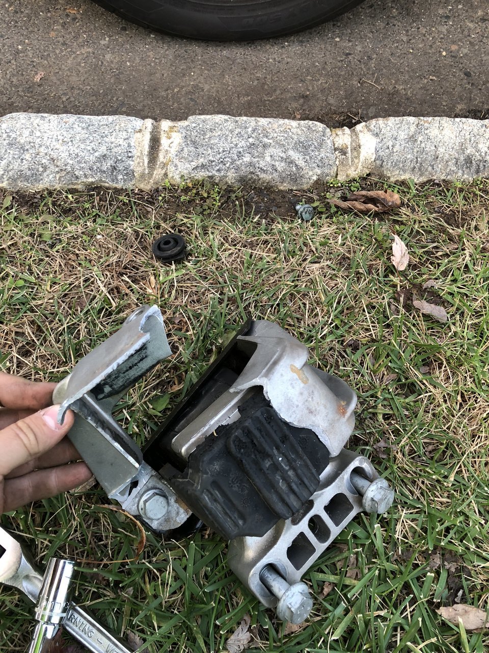

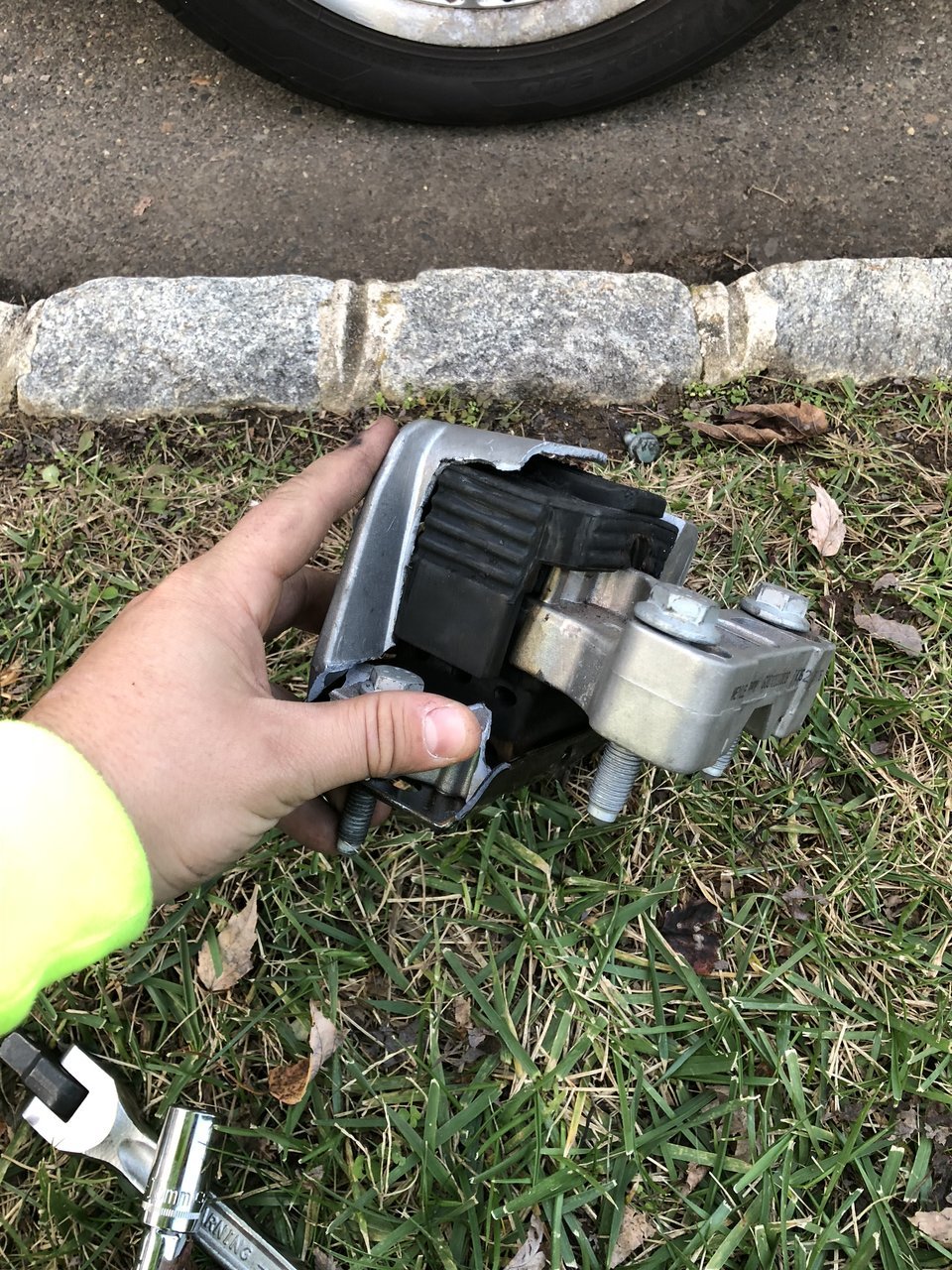

    So not tacoma related but this is what my transmount looked like after I made it explode...
    Bottom pic is what ts supposed to look like. I replaced it with a stiff stage 2 mount

    whys that steel seem so brittle? Shouldnt it have a bit more give to it considering its a trans mount?

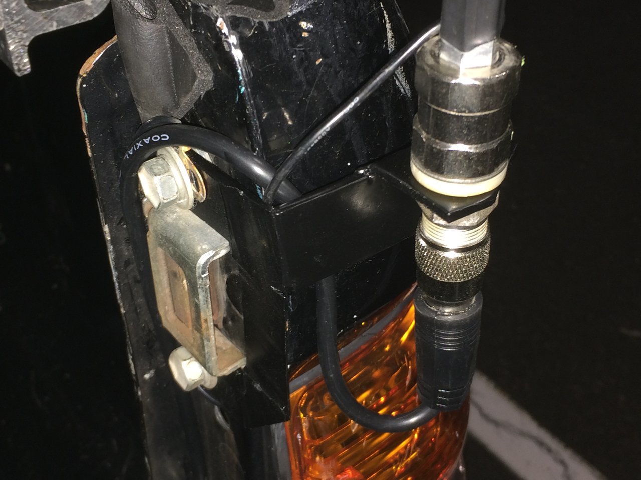

    Also, made myself a little cb bracket. 1/8" wasn't a wise choice, had to thin it out a bit so the tailgate would close properly. Not exactly overbuilt but sturdy enough

    Cast aluminum. And it was a cheap mount that exploded due to wheel hop in the VW

    @Lux I have all stage 2 motor and trans mounts now. The vibration to the chassis is pretty crazy but the power goes to the ground and not torqued into the mounts
