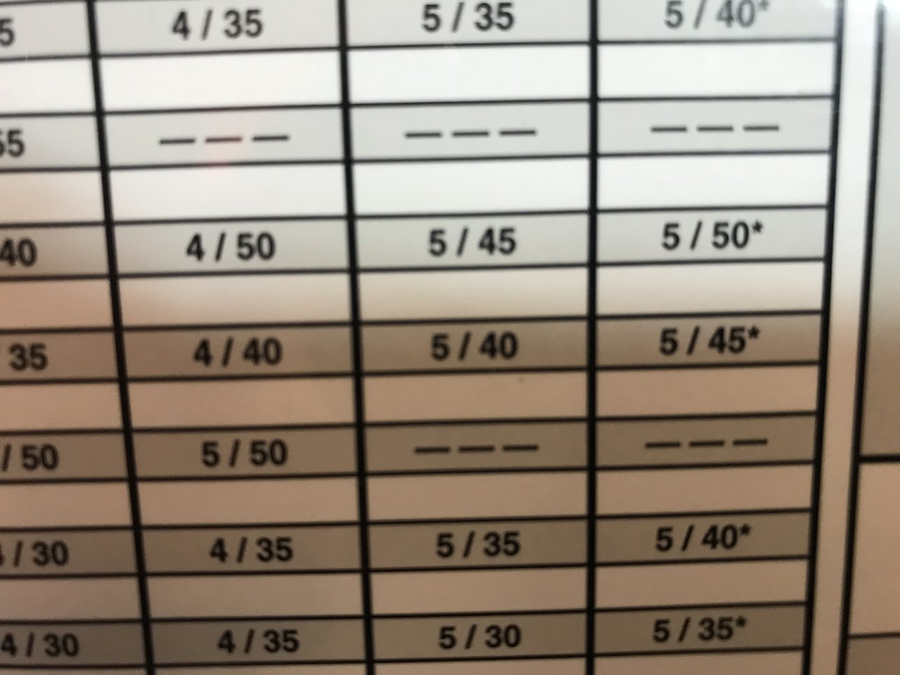

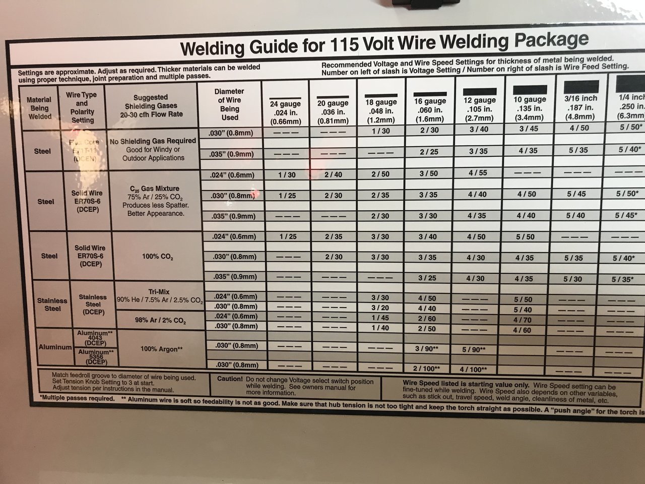

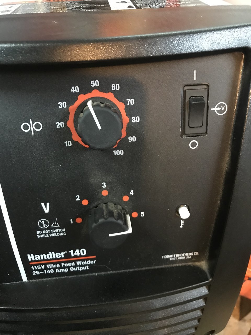

    I was welding at 5/45 as the cover says to do with steel .30 wire, 75/25 gas, & 3/16” material.
    No Bueno?

    Wire speed was below 30 in the pic I quoted.
    5/45 Sounds better.
    Angry bees sound means all good.

    Yeah, knob must’ve gotten moved. That’s not where I was using it though :thumbsup:
