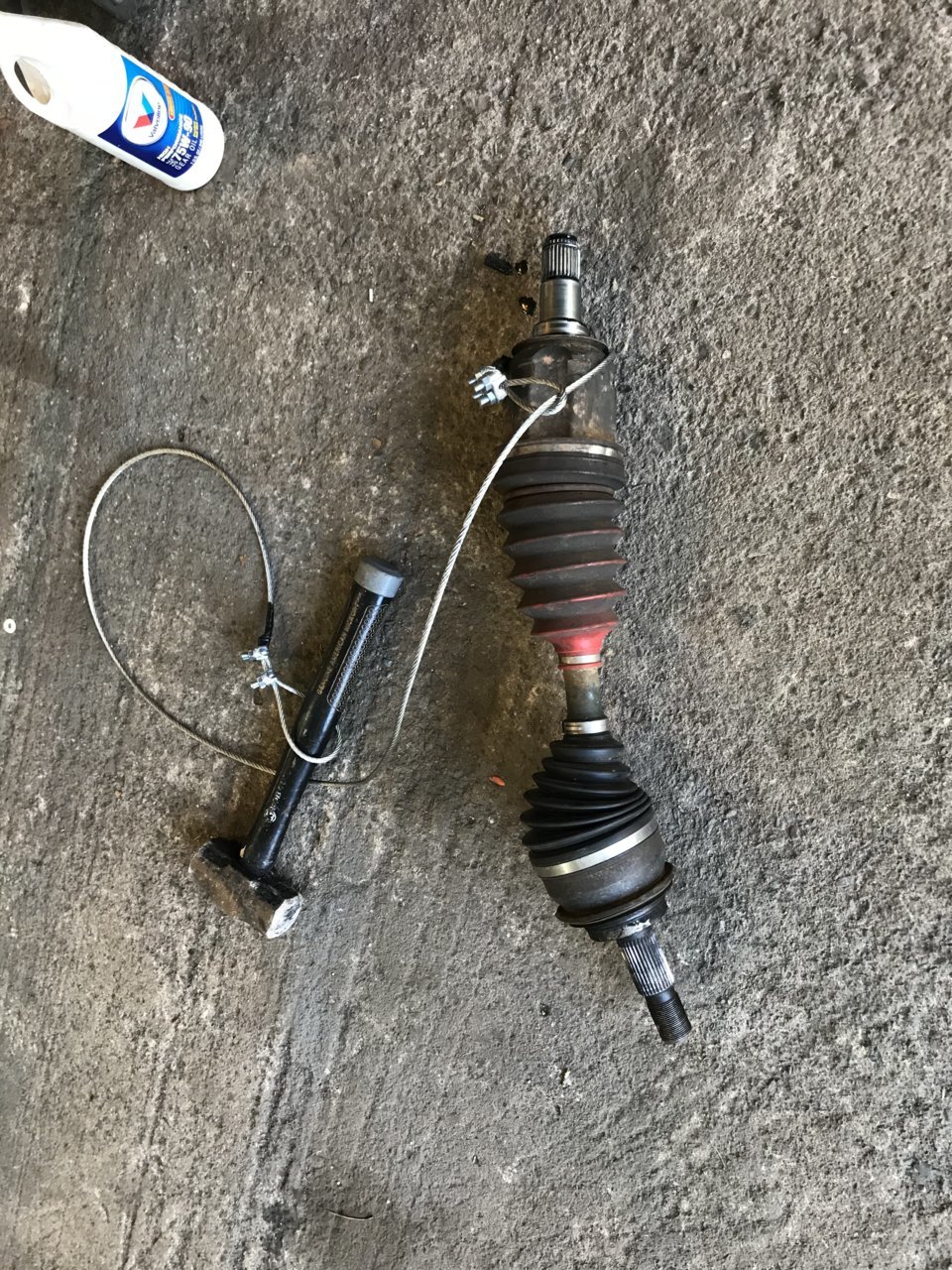

    If you haven’t done it already Floyd, make yourself an axle pulling cable.
    I always knocked them out with a pry bar and it worked great.
    THEN... I broke my first axle on a trail and realized I couldn’t get the damned thing out with the 85lb 1/4” skid plate in place.
    I took Jon’s advice and made this cable last weekend. Then, I discover that my passenger side outer CV was very tight. So, I tested the cable method. Two swings and the CV was out.
    Only a few dollars to make and takes up hardly any space.

    Oooh. That’s an easy cable to make.
    How long is it?

    I don’t know. I think I bought 10’ of cable, then just made it as long as it needed to be. I can measure it next time I’m in my truck tools.

    Actually, I never put the cable away. 6’ 3”

    Im guessing it just needs to be long enough to wrap around the inner part of the axle and enough clearance to swing a sledge?
    What diameter cable?

    EDIT: 3/16”
    Small loop on the axle end. Big enough loop on the hammer end to easily get the handle through. I made the loop on the axle end as small as possible while still being able to get the bigger loop and clamps through it. This way, you get more contact with the axle. Use two clamps for each loop.
    Loop the cable through itself in a noose around the back of the inner axle. Pull it tight, slip the hammer handle in the other end, swing, rotate 180*, swing again. Repeat as necessary.

    According to my calipers, it’s 3/16”
    I bought it a while ago. Just got around to doing it this past weekend. I remember now that I couldn’t remember what size Jon said he used. I just bought what seemed right.
    It worked.

    Think mine is 1/4". But 3/16" is more than strong enough, and will be more flexible.
