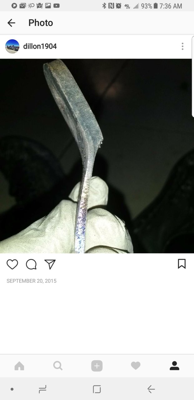

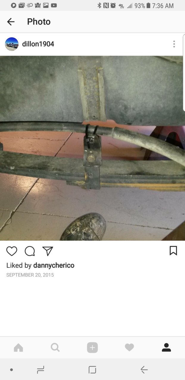

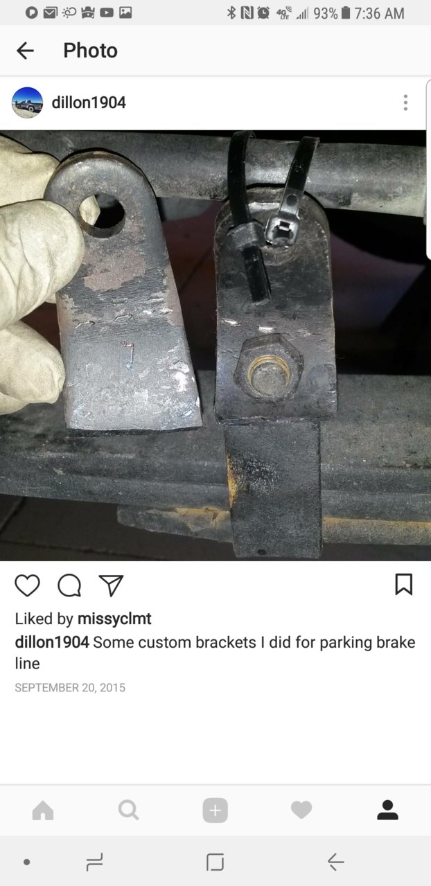

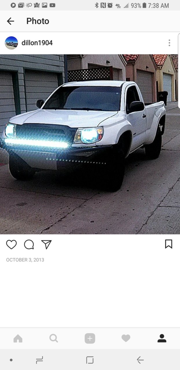

    i made these just for that

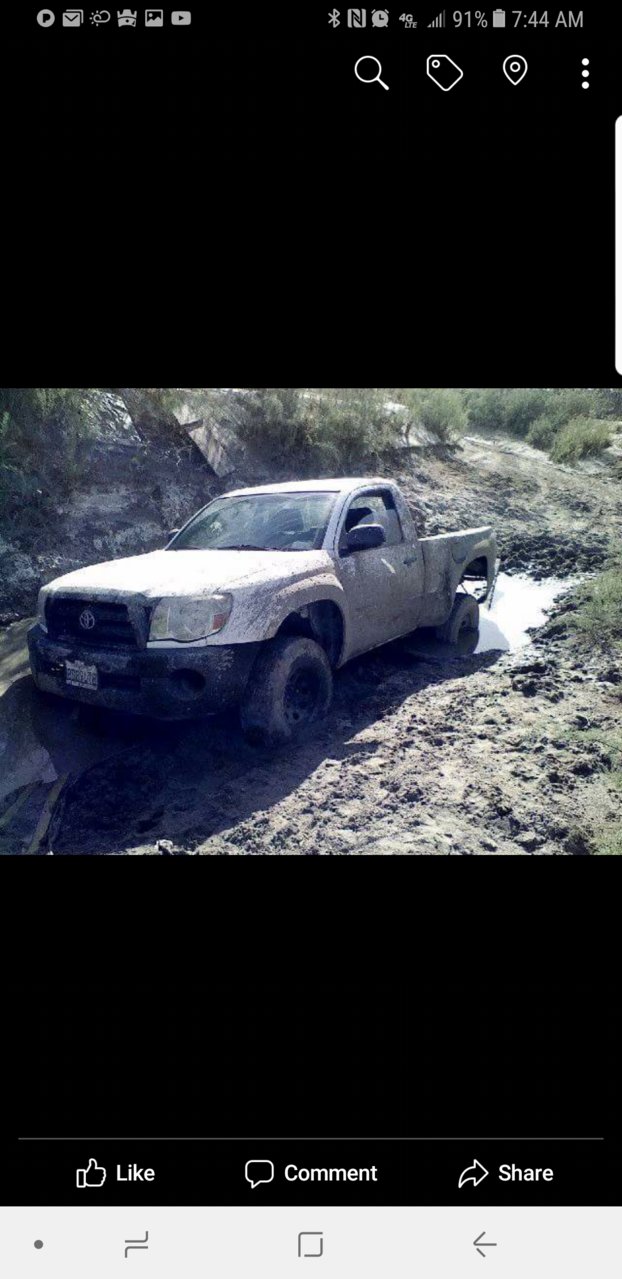

    found some really old pic thought you guy would get a kick out of it

    Drop bracket lift and booger welds
