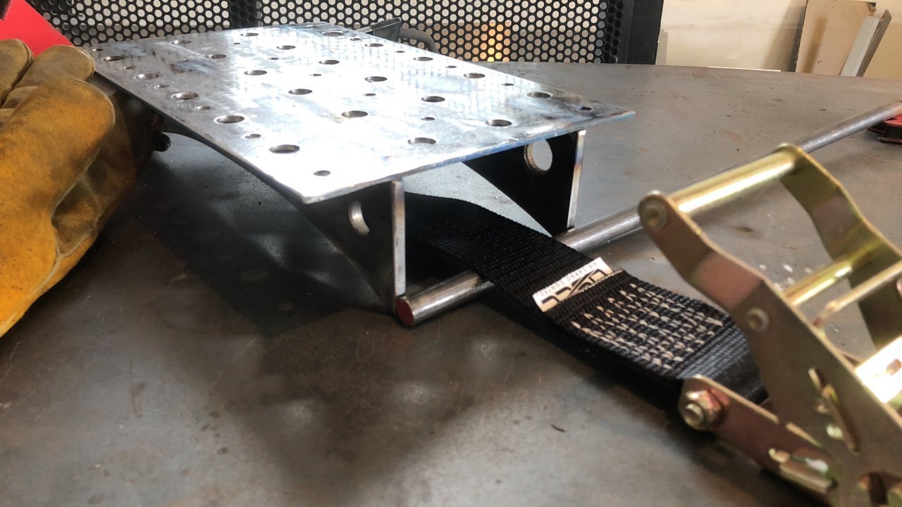

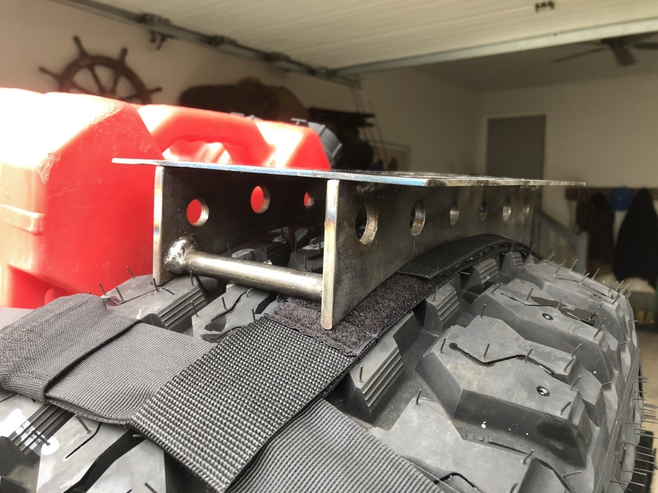

    I’m such a visual person and I got lots of pics I’ll flood my build with. I’ll just drop a couple here. Just finished the chainsaw spare mount, or anything spare mount.. Came out good, so good I decided to get it powder coated over spray painting it. I did wanna do this out of aluminum but not setup for it yet, in steel it weighs 5.3lbs

    Very cool. How will you attach it to the tire? Ratchet strap?

    Yea round the outside of the tire. Got an infinite ratchet stra from US Cargo Control

    Cool part that I didn’t plan is if you look at the top pic in the previous post, the one leg is on the trasharoo tension strap. I’ve never used them from the several I’ve had till not to long ago as a why not. I found a second one and plan to put it under the other leg of the mount.. There will be compression cushion and zero contact to the tire with this mount ratcheted down.

    That case out great man. Looks bad ass with the holes.

    Building as I go. The top plate holes were 1/2 the amount as anchor points, than drilled out the 1/4” sides to trim a little weight, than drilled out more of the top plate. Gonna look great after powder coat. That stuff makes everything look amazing.

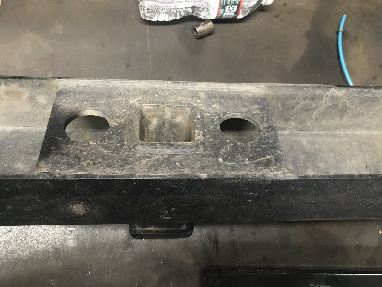

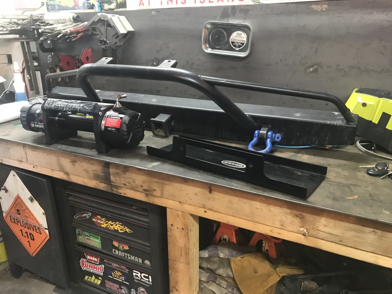

    Tomorrow’s project. I’m going to turn the XJ bumper into a Winch bumper.

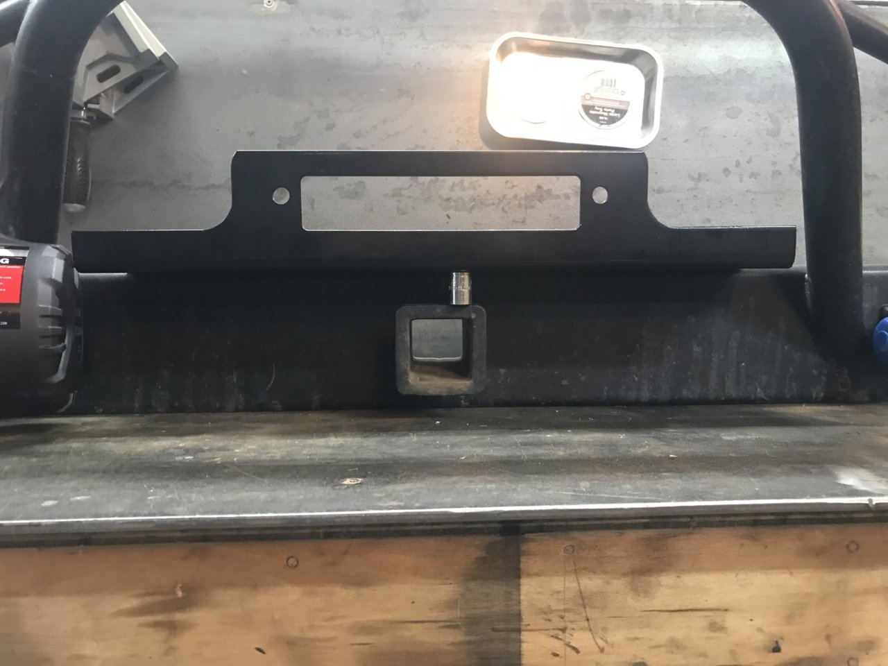

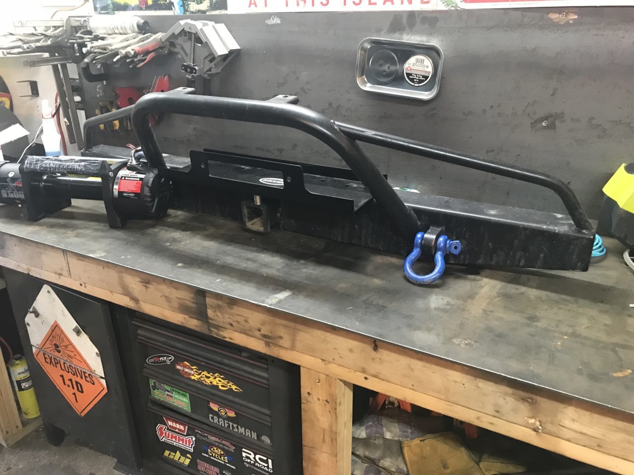

    The middle of the bumper is already reinforced for the 2”receiver. I’ll add more 3/16” plate to reinforce it at least the width of the Winch plate.
    Then weld the plate to the top of the bumper like so. With gussets on both ends, and another between the 2” receiver and the Winch plate.
    After @El Dahs had to turn around on a black trail to Winch Karen last weekend, her “I don’t need a Winch. I don’t get stuck” attitude ceased to be valid...
