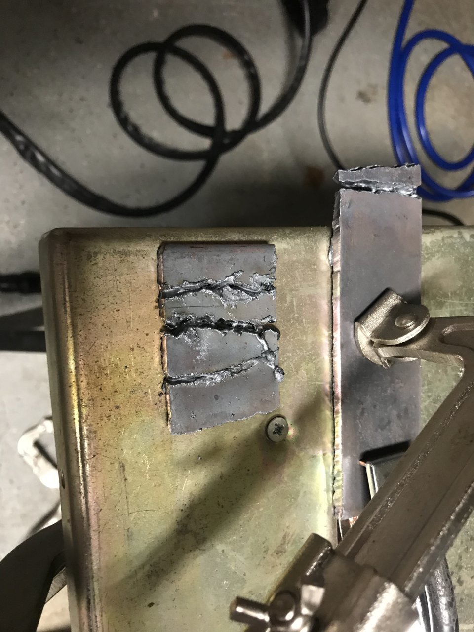

    Tried plasma cutter for the first time. I suck at it.
    Gonna put it down. Take a deep breath. Regroup. Watch some yoo-toob tutorials tonight and try again tomorrow.
    I need to get some little fab/welding projects done and my TC Cam Tabs.

    You don’t need a tutorial. You need a straight edge clamped to what you’re cutting and some extended tips.

    I can do a straight edge. What speed do you drag the top across the material?
    Also gotta figure out Amp the settings I need for 240v.
    So I need to increase the amps or slow my speed across the material to make a clean cut?
    I don’t think the Plasma Arc version has extended tips. I’ll check.

    I’m not an expert by any means. If you turn up the amps and air pressure, and slow down, you’ll get through the material.
    The stand off should help. With the extended tips, mine runs better and I don’t see the need for a stand off.
    These are what I use
    PT-31 LG-40 Plasma Tip Nozzle Electrode Extended Cutting Consumable CUT-50 CUT-40D 40pcs https://www.amazon.com/dp/B01DNOYQ68/ref=cm_sw_r_cp_api_XTLzBb54D2044
    Looks like you changed your head though?
