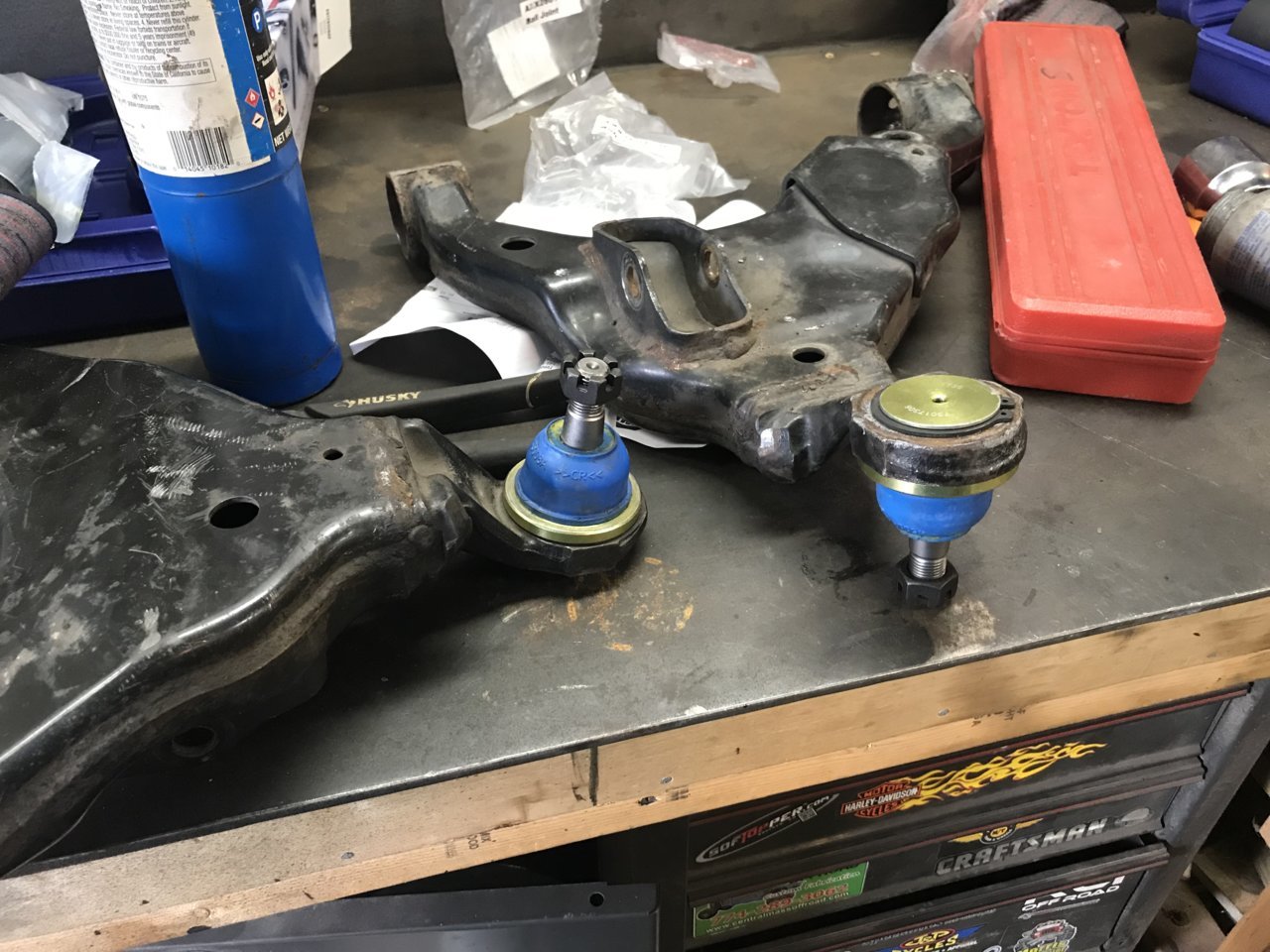

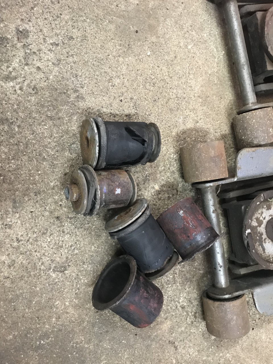

    Old bushings and sleeves out. New BJs in.
    Can't figure out a good way to press the bushings in.
    Shop press just kicks out, BJ press won't fit because bushing + Adapters are too long, bench vice wont open wide enough.
    I'm going to see if the big vice at work will open enough tomorrow. If not, I’m going to try @stairgod ’s suggestion and try to pull the bushings in with threaded rod, washers, and nuts.

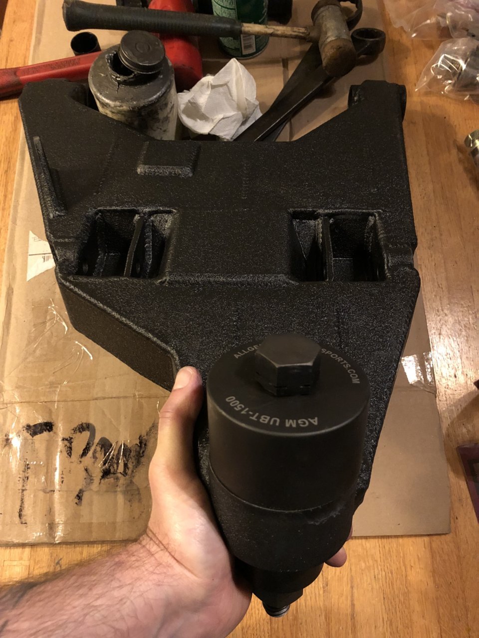

    Hmm, think something like this would do the trick? It’s a uniball press. I have 1” and 1.5”DB701E2F-6968-4594-B6ED-8B70DBEB30A5.jpg
  12. Aug 5, 2018 at 6:24 PM
    stairgod
    stairgod NOOB
    Aug 16, 2015
    #161924
    7,965
    Jo n
    PA/NJ
    2011 MGM Trail Limo
    Locked Boosted 35s
    That is one beefy LCA. I am still pissed that I didn't get the Dirt Designs kit
    Edit: I know that is the DK LCA in that pic
    Hawk373[QUOTED] likes this.

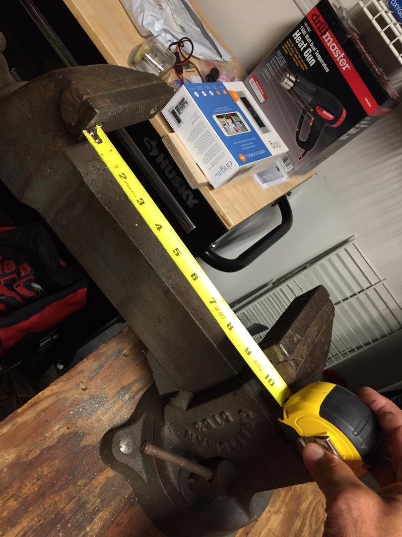

    Mine opens to about 9 1/2', you're welcome to come here if you want.

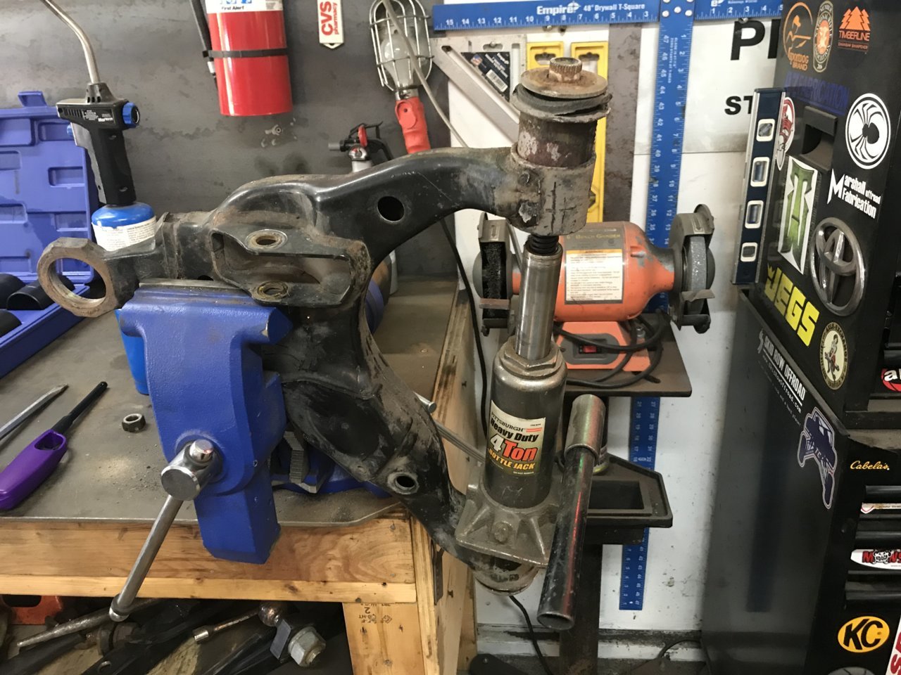

    @HolyHandGrenade i know this may not be a forum approved method but I just run them in without the adapters. I’ve done it with aftermarket poly bushings and oem bushing with no ill effects. When the bushings are new they are stiff enough to handle being pushed from the middle.
    Akchooally I use a large cup on the receiving end but nothing on the side being pressed on. @Chux yuesd to have a video from when we did his
