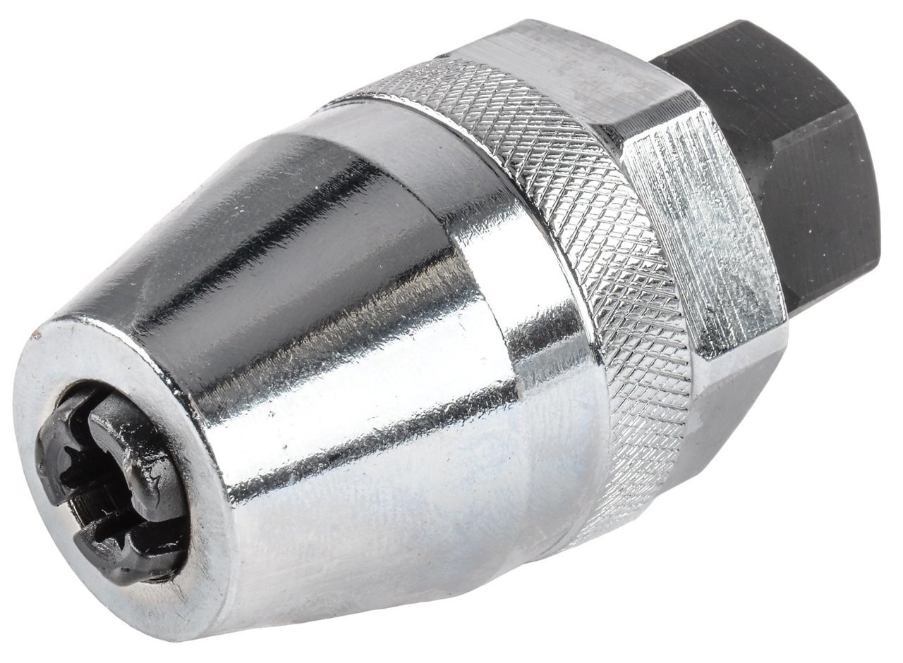

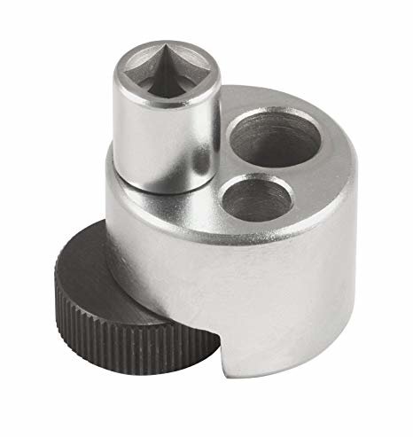

    Worth while?

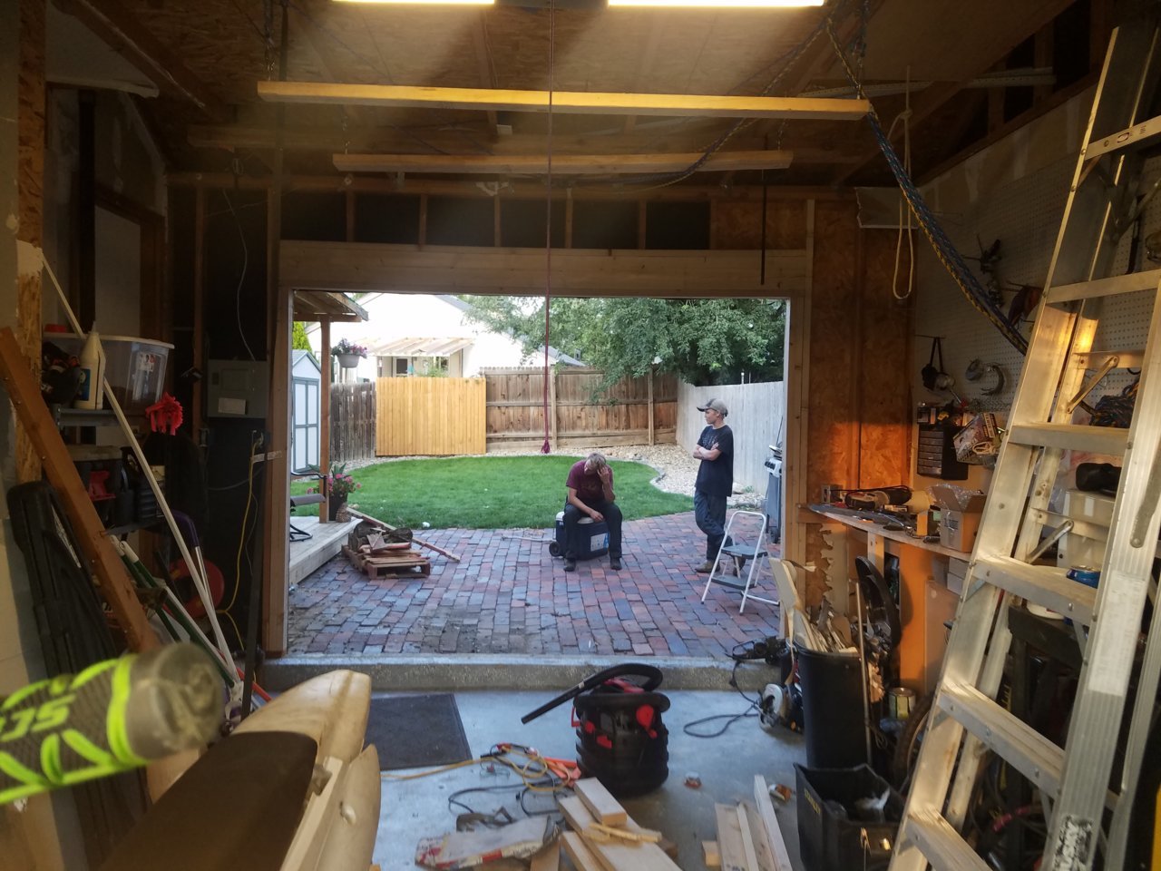

    Truck mods have been slow lately but I've been working on the house. Check out the new drive through garage :eek:;). Thinking of pouring a slab and putting a lift where the bricks are.

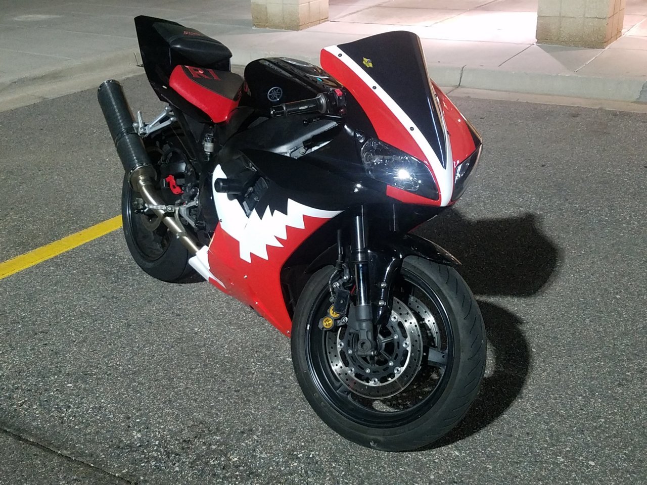

    Oh and I vinyl wrapped my R1

    Worked every time I needed it to. But make sure you add heat or a pre-soak with penetrant. Obviously will not remove broken studs.

    Rgr that. Going to try the heat and wax technique I just read about. Sounds like a winner. Thanks!

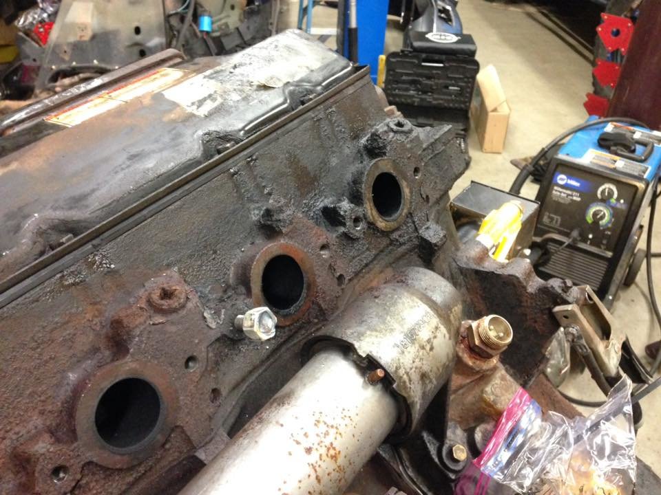

    welding a grade 8 nut to a broken stud/bolt works better than any tool that can be purchased from my experience.

    I had two nubs when I did mine last week, one on each side. Welding that nut made it easy to just put an impact on and zip it out
    38292817_10117390656861134_6802502935801_1abedadf3164afa47025b4b49a0fbedcc45529a0.jpg

    Not when the threads get stretched when it breaks off.
    Pro tip: the welder is always "out" :)
