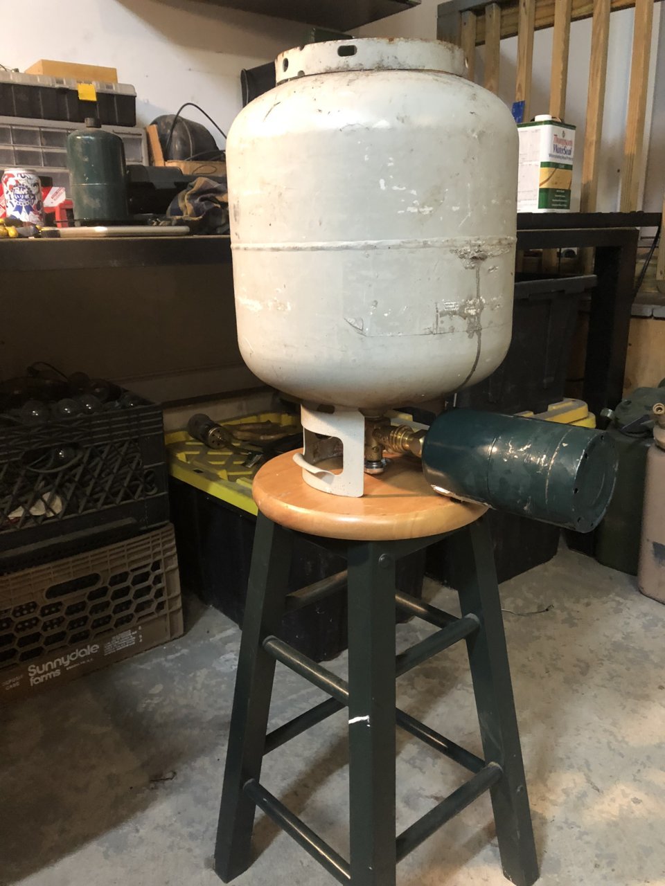

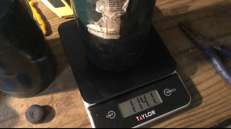

    Last night first attempt at refilling 1lb propane bottles. Success

    I have that same adapter. I really like it. I never bothered to weigh them though. I guess I just figured it is what it is.
    This reminds me. I need to fill a few before our trip.

    Heating up the parent tank and chilling the smaller tank makes it go quickly and get a better fill in my experience. I do the same thing.

    I put the big tank in the sun and the small tanks in the freezer :thumbsup:
