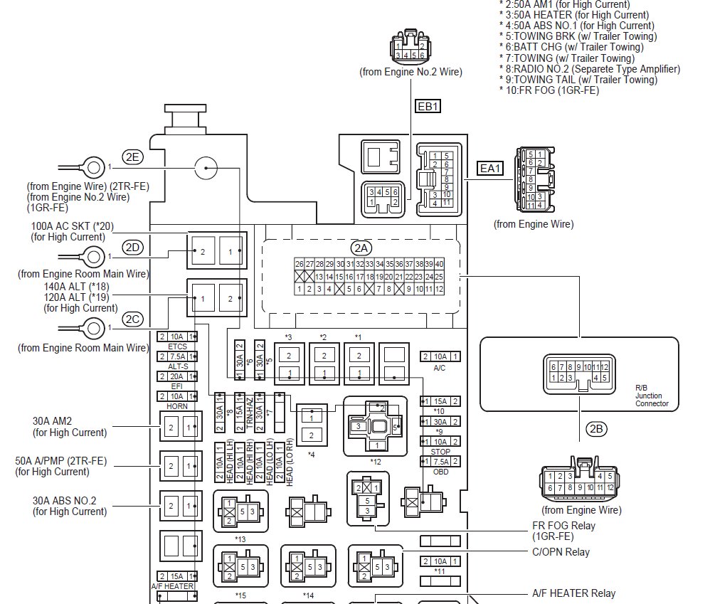

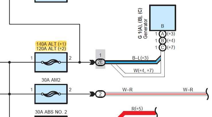

    Did the wire that goes from the positive battery terminal into the fusebox become disconnected or loose? Labeled as "2E" in this picture. It is daisy chained down to pin 1 of all the high current fusible links.

    thats what Im thinking because I moved the fuse box around a bit. Trying to get in there to check

    If your main 140 amp alternator fusible link is blown it will cause all downstream power to be lost as well. To replace that fucker, you must unbolt the fuse box and unbolt the link from the bottom to remove it.

    Okay, so the 2E wire was not connected properly from me moving everything around. I now have dash lights and everything, truck wont start, I think the battery needs a deep cycle charge from sitting on my bench for 6 weeks so doing that now. Thank you!!

    Sounds like you will have to trace the conductors from point to point. Start at the positive terminal on the battery, then trace until you lose juice. Small circuits on modern cars can flow in opposite directions depending on how it is operating.

    yea thats what I was doing and AM2 was the first one I tried. so glad it was an easy fix. full disclosure, my truck caught on fire a few times during the tub for 37s so I had to redo the wiring harness and swap the 4wd ECU and I was praying there werent more things f*ed up. phew. not out of the woods yet but at least im making progress
