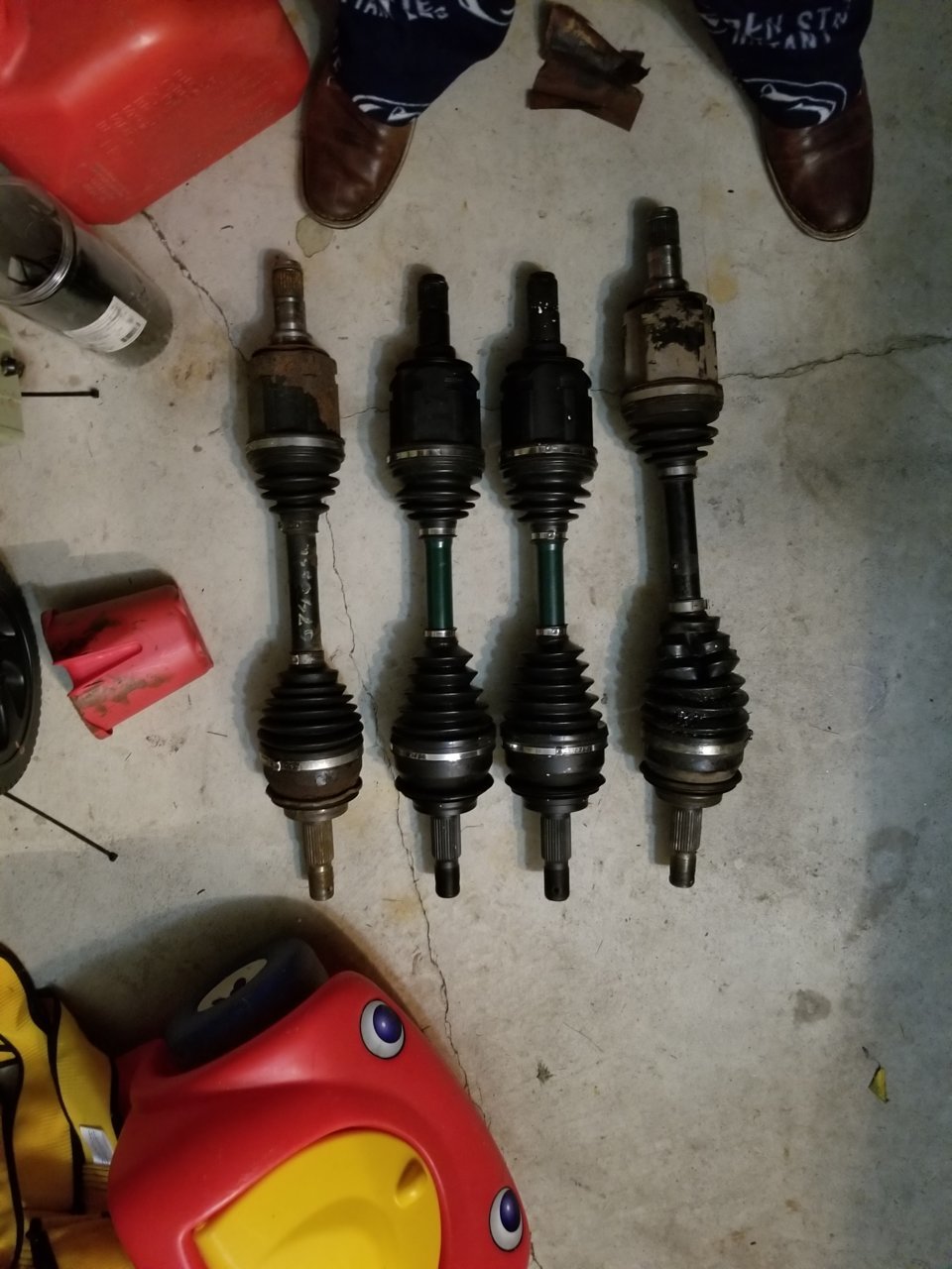

    Anyone have any experience with CVJ axles. I ordered 2 CV axles and they are about 1in shorter than OEM axles. I'm going to give them a call Monday but curious if anyone used them before. The outside ones are factory and the inside ones are CVJ.

    CVJ axles are rebuilt OEM axles. Not sure how they would be shorter.
    Obviously, I see the picture. Are you sure the old axles are not just pulled apart a little from being removed?

    Yeah measure the axles full pushed together, there is a lot of play at the tulip joint. @planters15

    The only CVs that I know are definitely shorter than OEM are from Advance. Learned the hard way

    what part number they send you? should be written right on the box they shipped the parts in
    i just received two axles from cvj for my 2012 with the oem outer and red inner boots, the part number I ordered was 9808RT (the rt was for the boots) if you went with the neoprene boots you should have 9808 IIRC
