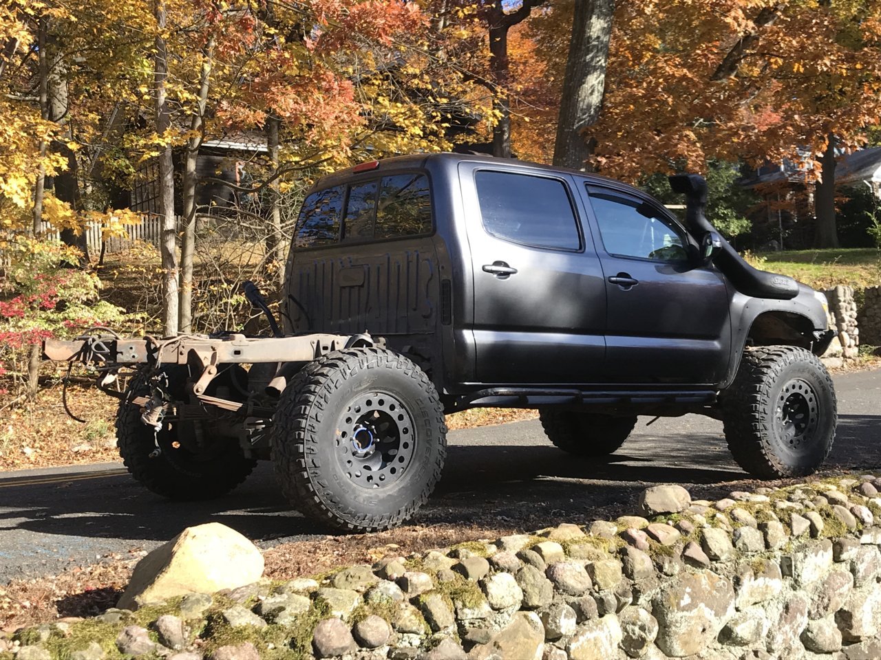

    What do you mean by weld it up?
    I bought the matching front and rear axles from an fj80 (i have the factory toyota elocker version). Im using stock housings with the fj80 4link brakes cut off and a set of leaf spring perches welded on. You'd probably need a wider after market housing and shafts for a second gen though

    I just meant build the axle yourself.
    Right, then we're back into getting the wheel speed sensors on the new housing.

    What's the question on speed sensors?

    Oh, hey. Just how to get them to work on an aftermarket, or junk yard axles.

    Call up diamond axle and price out an fj80 housing and shafts with wheel speed sensors, ill bet its less then the currie stuff....
    http://www.diamondaxle.com/rear_nonsteering.htm

    Well, that's a good point. The manual transmission picks up the speed from the transfer case, so I didn't have to worry with that wiring.
    Your tcase, if still Toyota, will have the spot for the speed sensor.

    Yup. FJ case. I did not know this. Cool
