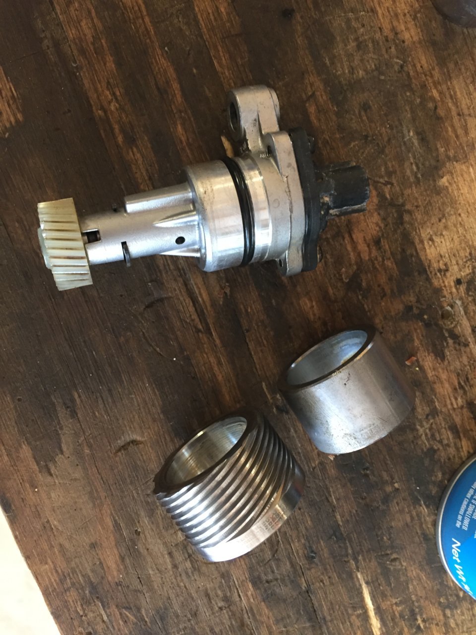

    Here's the sensor. The T4R case I have in the rig now had the smooth gear, so I had to pull the gear out of my old FJ case. Your FJ case will have the gear in it.
    The cylindrical casting below the rear output is where the sensor goes. Pull the blockoff plate and make sure you have the gear you need. Also, I hear you can change out the gears for corrected speedo readings.

    No problem. Find the input wire on your speedo, a few junkyard parts, and wire it up. No need for sensors on the hubs.

    I'd do a 14 bolt or the Toyota 9.5" in a ruff stuff or diamond housing. Simple and plenty of beef. As said the speed sensor is in the tcase for those of us who shift like men, otherwise you can just get a new speed sensor and splice it in, it's 3 wires.
