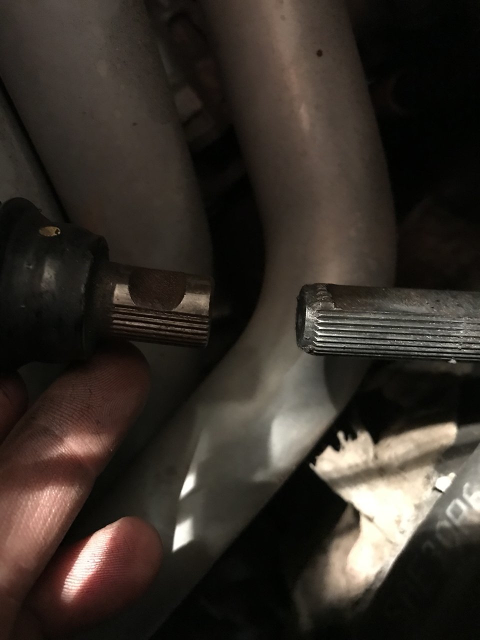

    OK, I just pulled it apart to see exactly how much spine there was engaged in the connection.
    I’m sure some of you already know this, but there is a notch in the steering shaft on both sides of the gap that the bolt fits through.
    The upper notch is longer allowing the connector to slide when loosened. The bottom allows for a little movement, but not as much as the top.
    It is designed to not pull apart however with the bolts installed.
