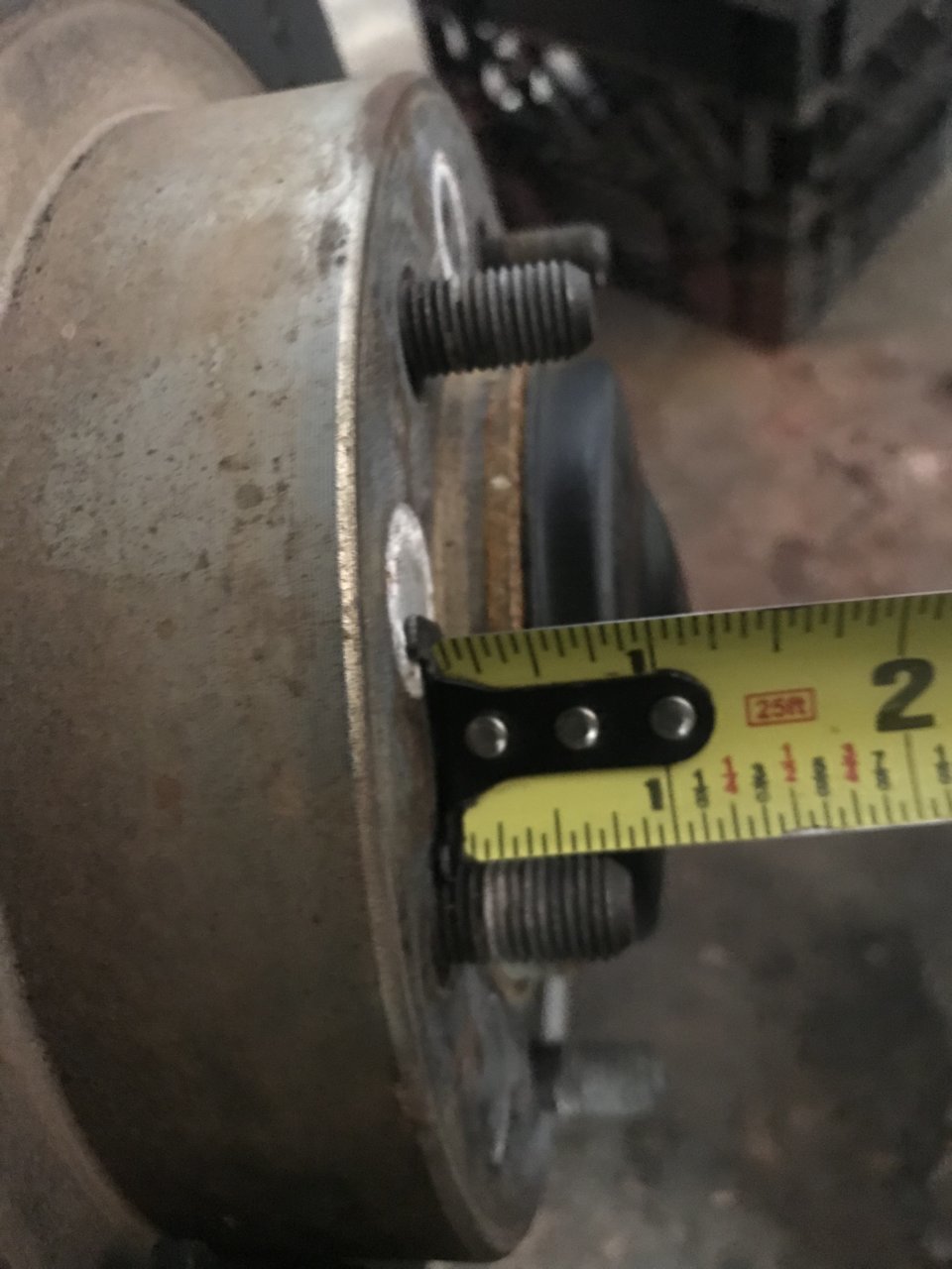

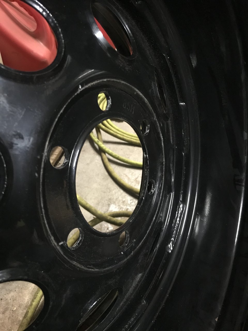

    3/4" spacers will work on some aluminum rims without cutting due to the relief machined into the back of the wheel mounting surface(if present, depends on the wheel). Steelies have no such luck and the studs will have to be trimmed.
    Steel wheels will bend at the bead area much easier than aluminum rims, but can also be bent back and put back into service right on the trail. Aluminum rim breaks and you are screwed until you can get it welded(and the integrity of that repair depends soley on the quality of the casting. Generally cast aluminum is filthy and welds like shit).
    Rock rings welded to the outer part of a steelie(like Tim did to his last set) greatly increases the strength of the bead area, making then nigh invulnerable.

    I just checked. I think I’ll get away without trimming the OEM studs with these wheels too. The mounting surface is recessed.
    The OEM studs are 7/8” out past the rotor. The spacers will be 3/4” (provided they are large enough to keep the wheel center from contacting the calipers). The rececess on the wheels is 3/16”. If my math is correct, that leaves me precisely 1/16” wiggle room between the studs and back of the wheels.

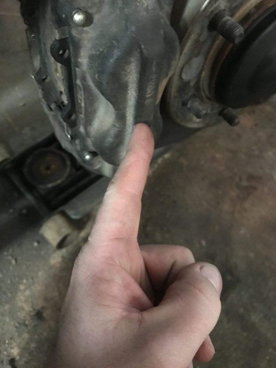

    I ain't no carpenter, but that stud looks to be 13/16" out from the rotor..

    It does look like 13/16” in the pic. It’s just the angle.
    Even so, that would leave me TONS of room :D
