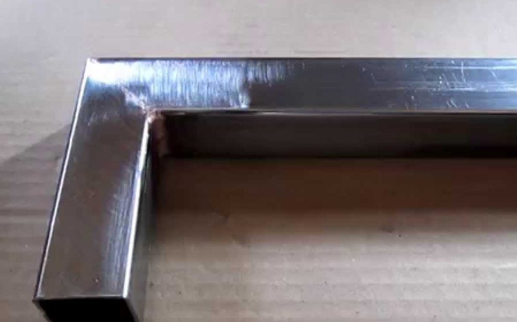

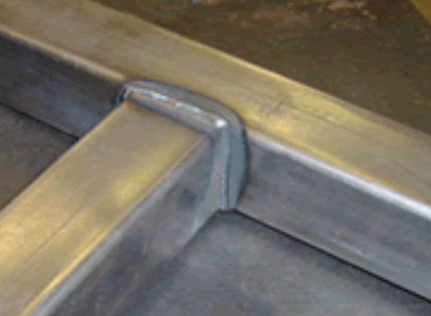

    Question as to the engineering design of this flat bed.
    Disclosure: No dickery here, just an open question on a public forum of pictures your posting in you build.. I mean NJ Thread.
    It caught my eye early on to all the square toob openings.. I figured your gonna fill them in but why not design it from the get go to be closed where they can. Like 45°s at the corners near the cab and the outer rail be one full piece and measure the supports inside to inside? I’m no engineer but I feel like structurally it would be better/stronger to have less joints, welds, pieces to the flatbed..
  16. Dec 14, 2018 at 7:56 AM
    V5ioV
    V5ioV My drinking team has a wheeling problem
    Sep 22, 2012
    #87502
    8,244
    V5ioV
    Out n 'bout
    '13 Pewp Water Slut
    King 2.5 Rem Resi Ext Travel w/comp adj w/700# springs, TC Uni-Ball UCAs, ARB/OME Dakar Leaf Springs w/ King 2.5 Rem Resi w/comp adj and custm eyelets, Stealth Custom Series F-5 Wheels wrapped on: 285/75/16 Fierce Attitudes, BORA 2.25 wheel spacers, GOODRIDGE extended Brake lines, Triple-6" Double Row LED Light Bars behind lower grill, ATFL MOD, TRD Ball Type Shift Knob, Husky WeatherBeater Floor Liners, 60'' HiLift Xtreme, 4xInnovations Bolt-On Sliders w/Kickout, Spring Hanger Skid, Custom BlackPipe Fabs CMC and custom FYL Bed Rack, CVT Mt. Shasta RTT, Trasharoo, 4xInnovations HiLift Bedside Mounts, 4xInnovations Front Skid Plate, TOYWERX Ghost Raptor thin-lip Satoshi Grill, RedLine Hood Struts, 4xInnovations Transmission Skid and T-Case Skid Plates, Wheelers Rear SuperBumps Bump Stops, All-Pro Off Road U-Bolt Flip Kit, UltraGauge, ARB OBA, Pelfreybilt HC rear Bumper, Rotopax system (Single Mounting Plate and Bed Rail Mounting Plate both with LOX handles.
    Also no engineer here...
    The way you are saying reduces the amount of welds but "maybe" reducing butting ends welds makes up for an overall stronger disign.....
    Like maybe this is better:
    Vs
    This:
    Also very curious.

    I'm not sure it makes any difference. The amount and size of tube he's using is so overkill for the application that any method will work.

    Wow. I never took you for a bully Jay :(
    I have an actual flatbed welder engineer working with me on this. Thanks.
    :D
    I could’ve made the cross bars 3” shorter and had the side pieces one piece. I thought about that after.
    As far as strength? Once it’s fully welded, I don’t think it really makes a difference.
    The side openings will be fully welded, then a rectangle 1/8” cap will go over to tie it all together.
    The rear tube will be cut off at the same angle as the side piece and capped.
    I’ll add inside corner gussetts later.
    Aesthetically, I’m not too concerned. I mean, I’m building it to be dragged across trees and rocks after all.
    Macro? I obviously don’t want the bed to look totally stupid.
    Micro? Not sweating the small details.
    Now, stop cluttering up my build thread with your dickeryness . GEESH!

    As far as strength I don’t feel there is a difference either, your technically comparing strong vs stronger... they both strong.
    I know you don’t care bout esthetics.. but the idea is work smarter not harder :D

    Technically, as long as the welds are done correctly they are stronger than the base material so on paper moär welds equools stronger
