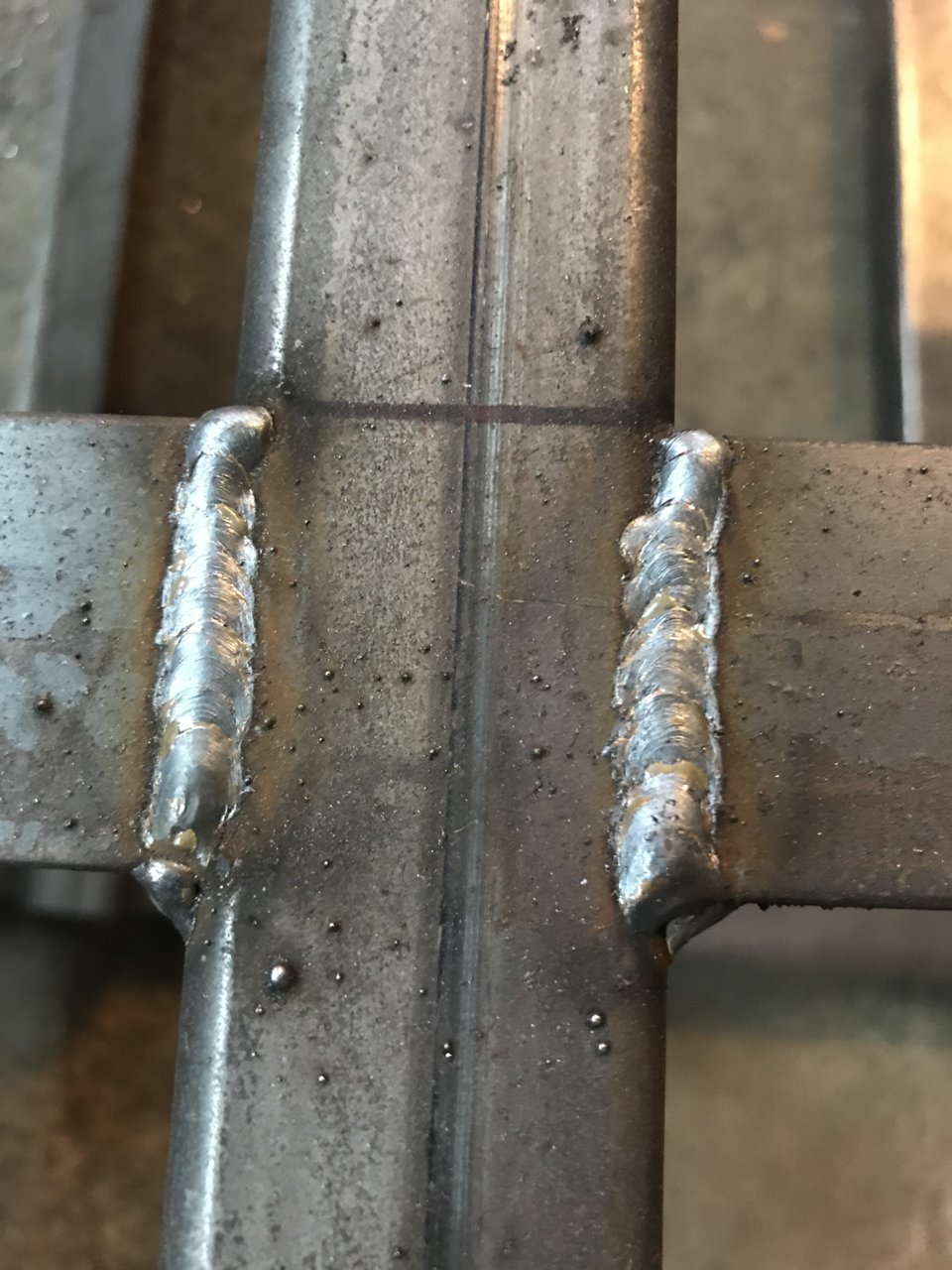

    Some Stuff
    One of those is slightly indented.
    Minusculey concaved, if you prefer

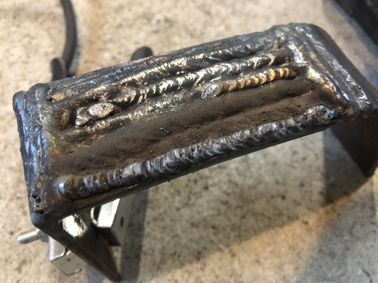

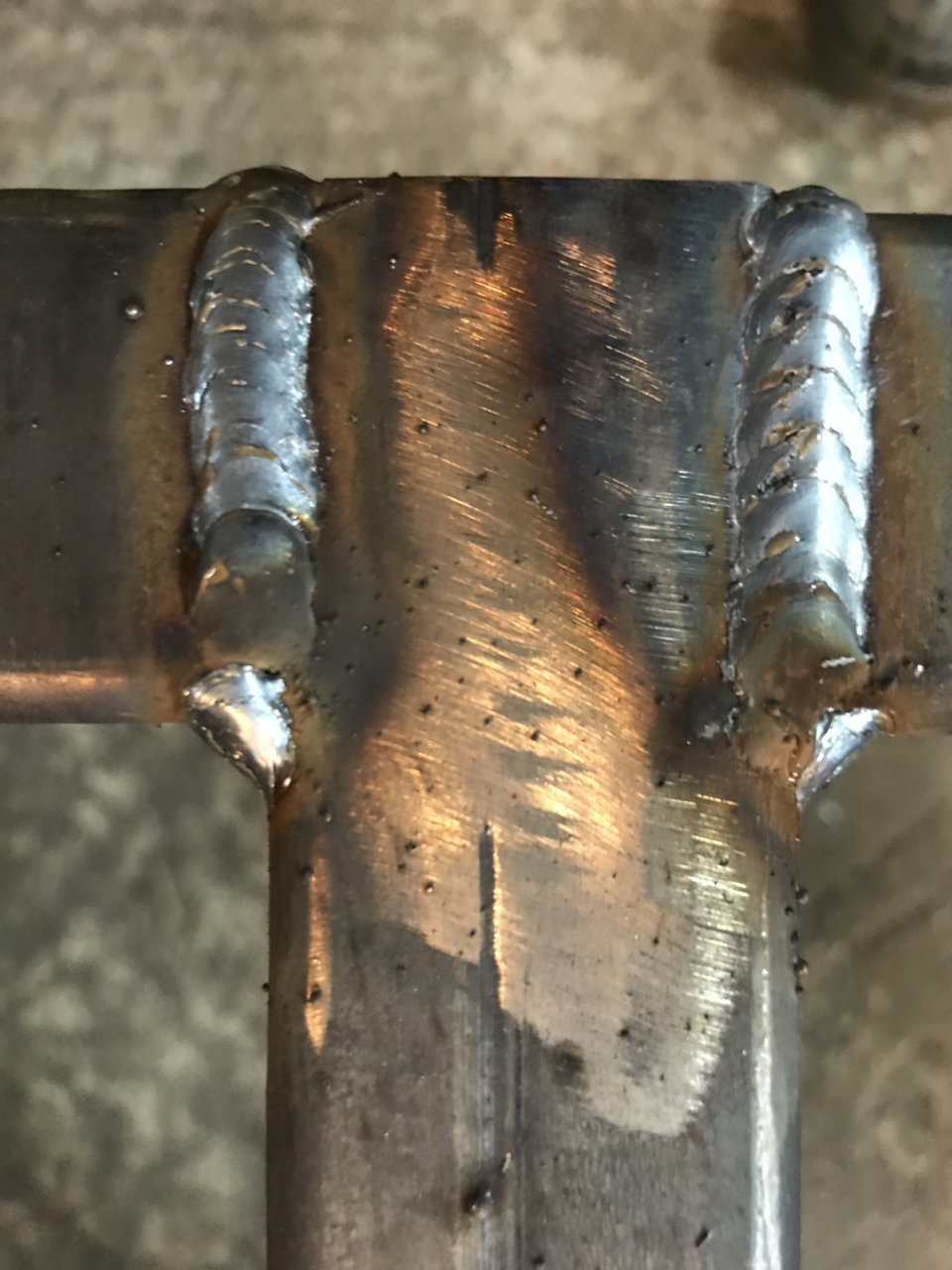

    Definitely need to turn that heat up!and wirespeed way down. I usually have my soeed at a 1.5-2 and heat somewhere in the mid to midhigh range but with a 110. Id keep a low wire speed though.

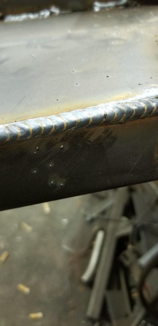

    I find the auto setting to be a bit too much for the recommended thickness. They make dull grey over heated welds. I think the auto setting for 1/8” is 18.0v at 385 feed; I’d use that for 1/4”.
    They’re good ratios though.
