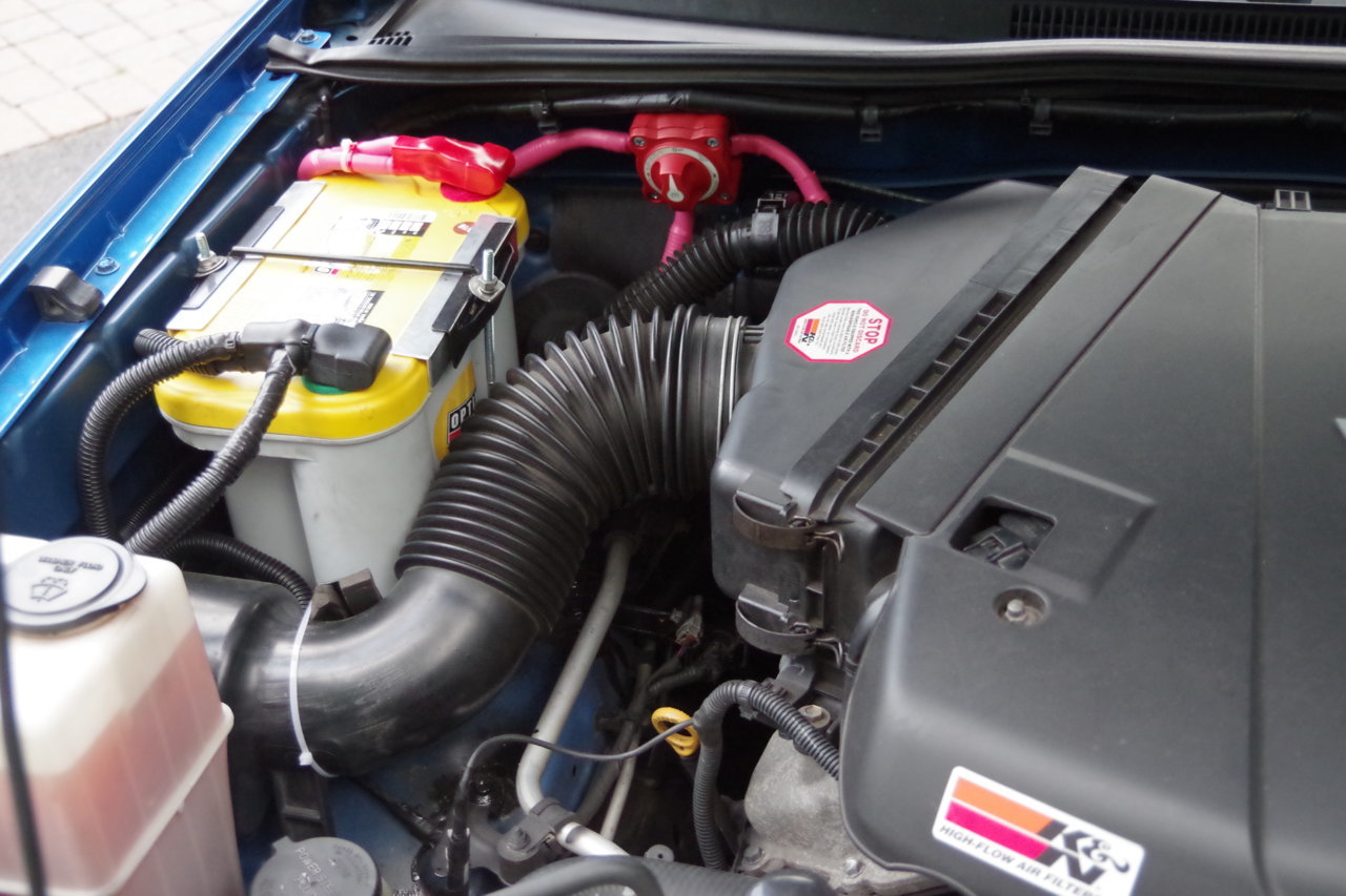

    I have a manual Blue Seas rotary switch at the highest point on the firewall in the engine bay. My reasoning is that I seem to dunk the entire winch during water crossings and I don’t want any electricity running to the winch while underwater (this is my opinion.) The switch also controls my rear bed electrical needs: fridge and compressor.
    The switches are usually in the “On” position while off-roading. I’ll switch the winch “Off” when crossing relatively deep water, but feel comfortable with the rear bed power still “on.”
    During heavy duty, high power draw pulls, the hood is either open or unlatched for quick shut-off access to the switch in case of fire or meltdown.
    Reading the horror stories on these recent posts leads me to think I might need an in-cab switch that controls a solenoid that controls winch power
