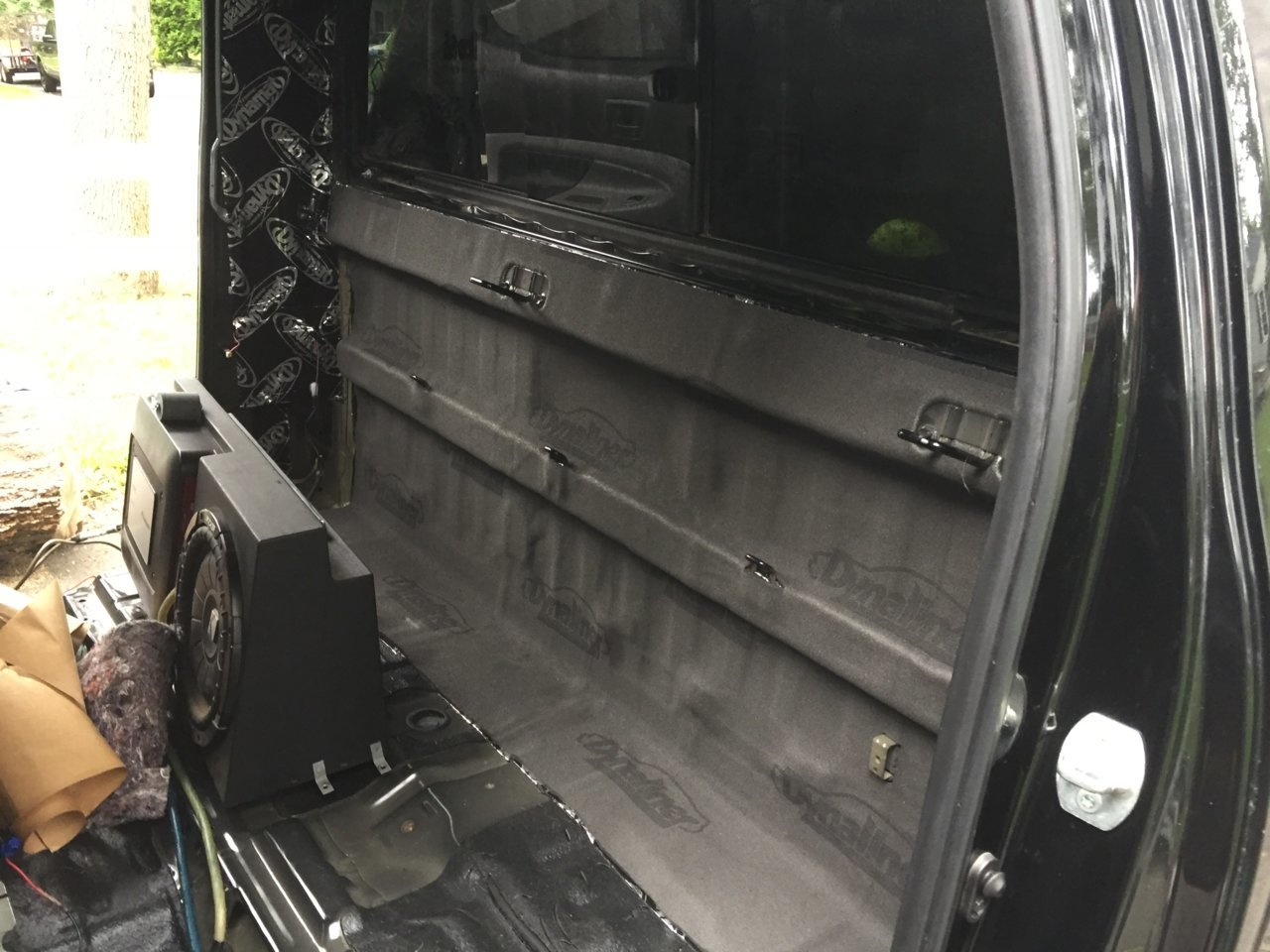

    Anyone here have any experience with sound proofing the cab?

    I already have the material, I was just wondering how much of an improvement was it? I’m more focused on all the noise coming from behind the back seats like the exhaust and tires

    Depends on how much surface area you do, but it can be extremely noticeable.
    Do it, you will not be disappointed. Start small and go till you are happy with the results.
    IMO for you... Back wall > floor > rear doors > front doors > roof

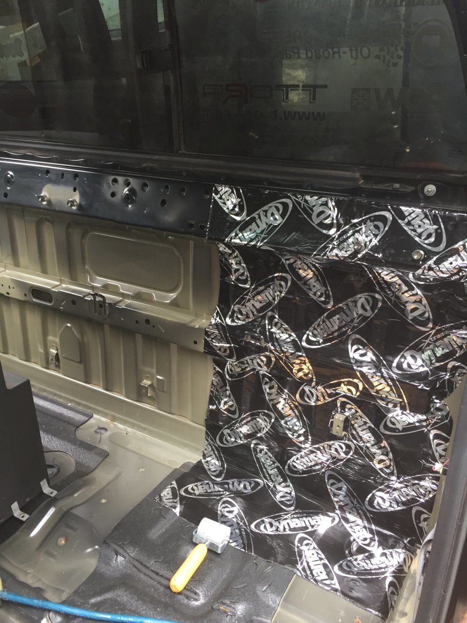

    Yea I think that winch should last you a while. I think it was the xrc8’s that had problems. Atleast those are the only shittybuilts I’ve heard of having problems.
    I used dynamat and it helps, mostly just takes the rattle out. I also used dyna liner (1/4” thick foam) and that makes a much bigger difference.
    I did the back wall of the cab, the roof, rear floor and under seats, and the doors.
    It’s a LOT of work gutting the interior to install it. I kept as much stuff in as possible, and tried to remember to punch holes for bolts as I went otherwise you might never find them.

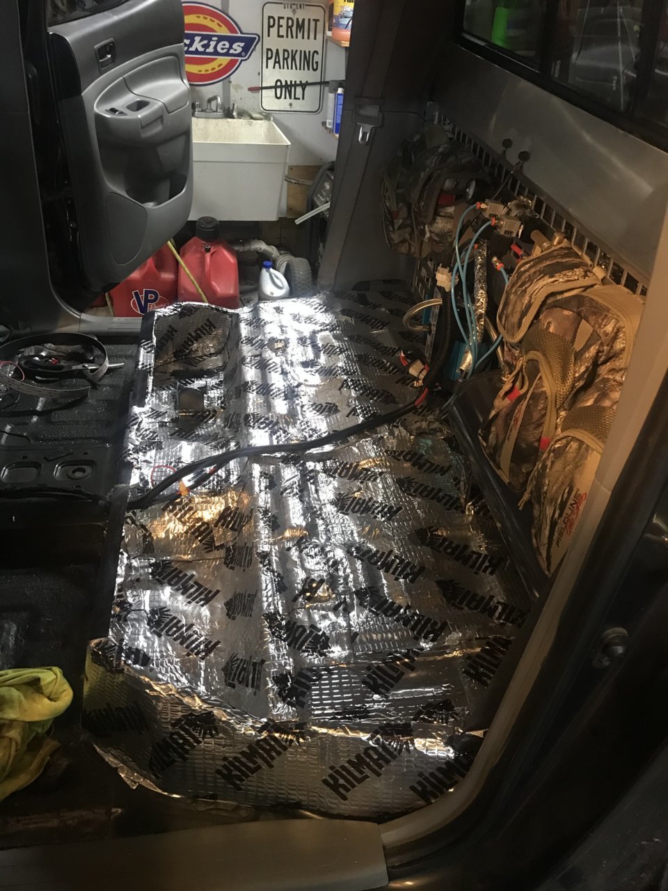

    I did the back wall behind the molle panel and the floor under the rear seats.
    I’m leaving my rear seat out. Just a platform for the dogs. Figured the matting would be a good idea.
