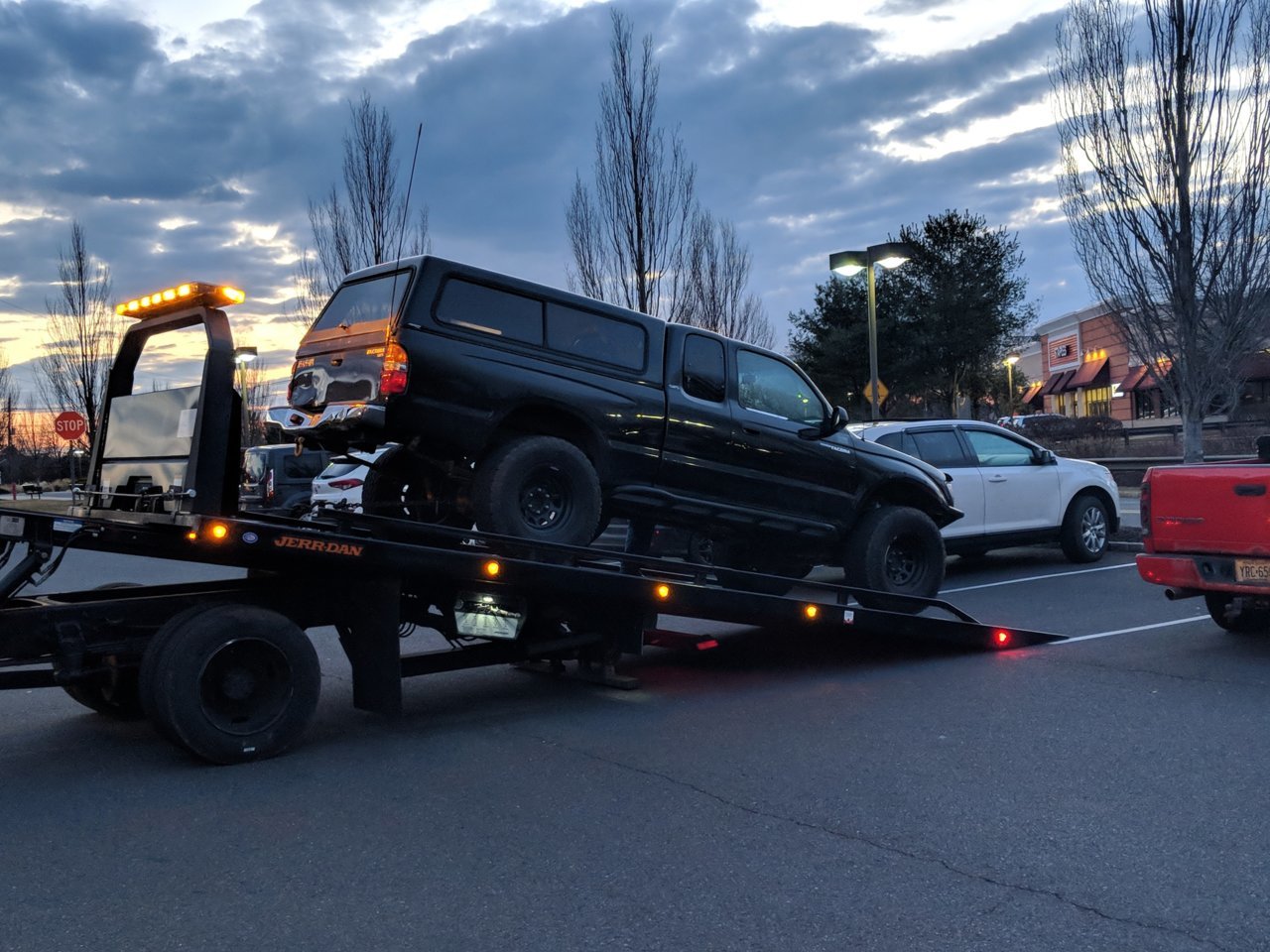

    Been having issues shifting for a week or 2 now, finally just couldn’t put it in gear at all, it would crawl with my foot to the floor on the clutch in first gear. My brother came to help me flush the fluid and hoped that would fix it but no dice and couldn’t drive it home. I’m thinking I’m likely gonna need a clutch job, if that’s the case this luk clutch lasted me not even 4 years.

    No expert here but I’d question the clutch master or slave cylinder first. If she’s moving I don’t think your clutch is actually burnt out. Been wrong before though :notsure:

    Yep sounds like a master or slave cylinder or a broken clutch fork.

    same dam thing with mine at 175k, replaced master and slave …….good to go !

    How’d you know they were bad? I have no leaks but when we flushed the fluid the pedal went really soft.

    Took a look at the truck, turns out the clutch fork is broken, I guess Ill replace that and the throw out bearing.
