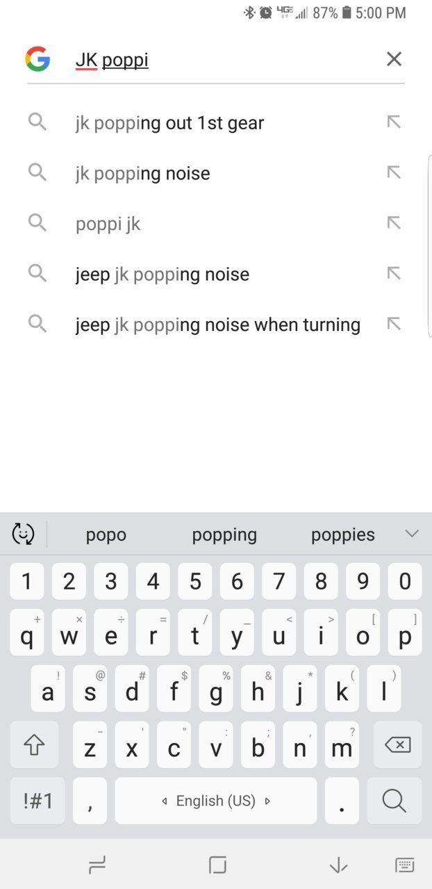

  1. Mar 19, 2019 at 2:01 PM
    V5ioV
    V5ioV My drinking team has a wheeling problem
    Sep 22, 2012
    #87502
    8,244
    V5ioV
    Out n 'bout
    '13 Pewp Water Slut
    King 2.5 Rem Resi Ext Travel w/comp adj w/700# springs, TC Uni-Ball UCAs, ARB/OME Dakar Leaf Springs w/ King 2.5 Rem Resi w/comp adj and custm eyelets, Stealth Custom Series F-5 Wheels wrapped on: 285/75/16 Fierce Attitudes, BORA 2.25 wheel spacers, GOODRIDGE extended Brake lines, Triple-6" Double Row LED Light Bars behind lower grill, ATFL MOD, TRD Ball Type Shift Knob, Husky WeatherBeater Floor Liners, 60'' HiLift Xtreme, 4xInnovations Bolt-On Sliders w/Kickout, Spring Hanger Skid, Custom BlackPipe Fabs CMC and custom FYL Bed Rack, CVT Mt. Shasta RTT, Trasharoo, 4xInnovations HiLift Bedside Mounts, 4xInnovations Front Skid Plate, TOYWERX Ghost Raptor thin-lip Satoshi Grill, RedLine Hood Struts, 4xInnovations Transmission Skid and T-Case Skid Plates, Wheelers Rear SuperBumps Bump Stops, All-Pro Off Road U-Bolt Flip Kit, UltraGauge, ARB OBA, Pelfreybilt HC rear Bumper, Rotopax system (Single Mounting Plate and Bed Rail Mounting Plate both with LOX handles.
    Very 1st suggestion!!!!
