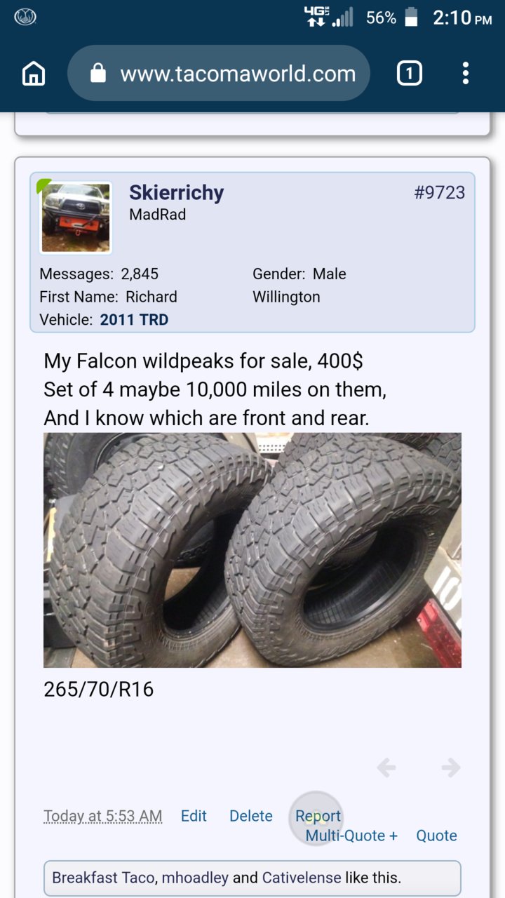

    Skierrichy
    Skierrichy MadRad
    Jun 10, 2018
    #256051
    5,397
    Richard
    Willington
    2011 TRD
    To many, but never done
  9. Apr 29, 2019 at 2:53 PM
    E-Paz 732NJ
    E-Paz 732NJ Well-Known Member
    Jan 27, 2018
    #242585
    1,216
    Eric
    NJ
    2015 Tacoma TRD-OR
    Where are you located ? Interested
  10. Apr 29, 2019 at 3:03 PM
    Skierrichy
    Skierrichy MadRad
    Jun 10, 2018
    #256051
    5,397
    Richard
    Willington
    2011 TRD
    I'm in the Northeast part of CT
