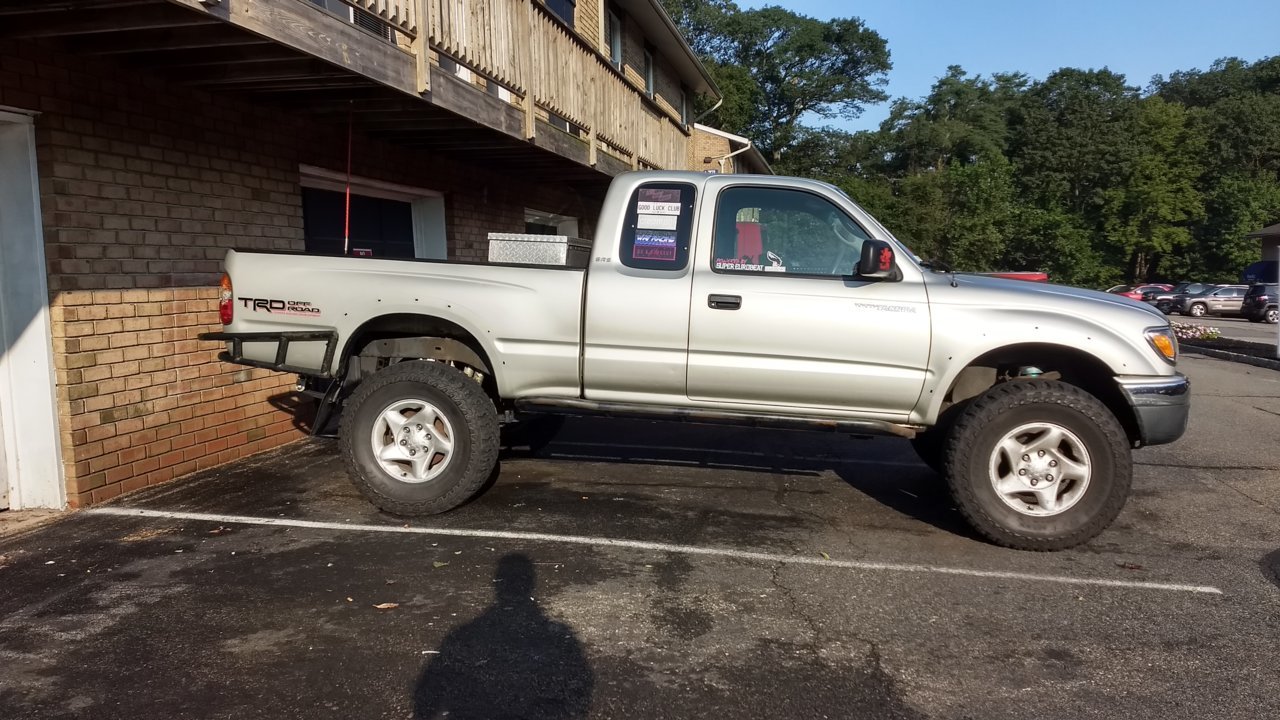

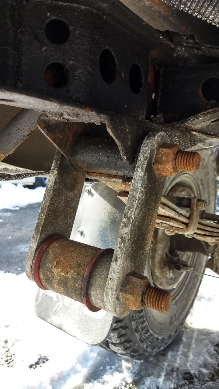

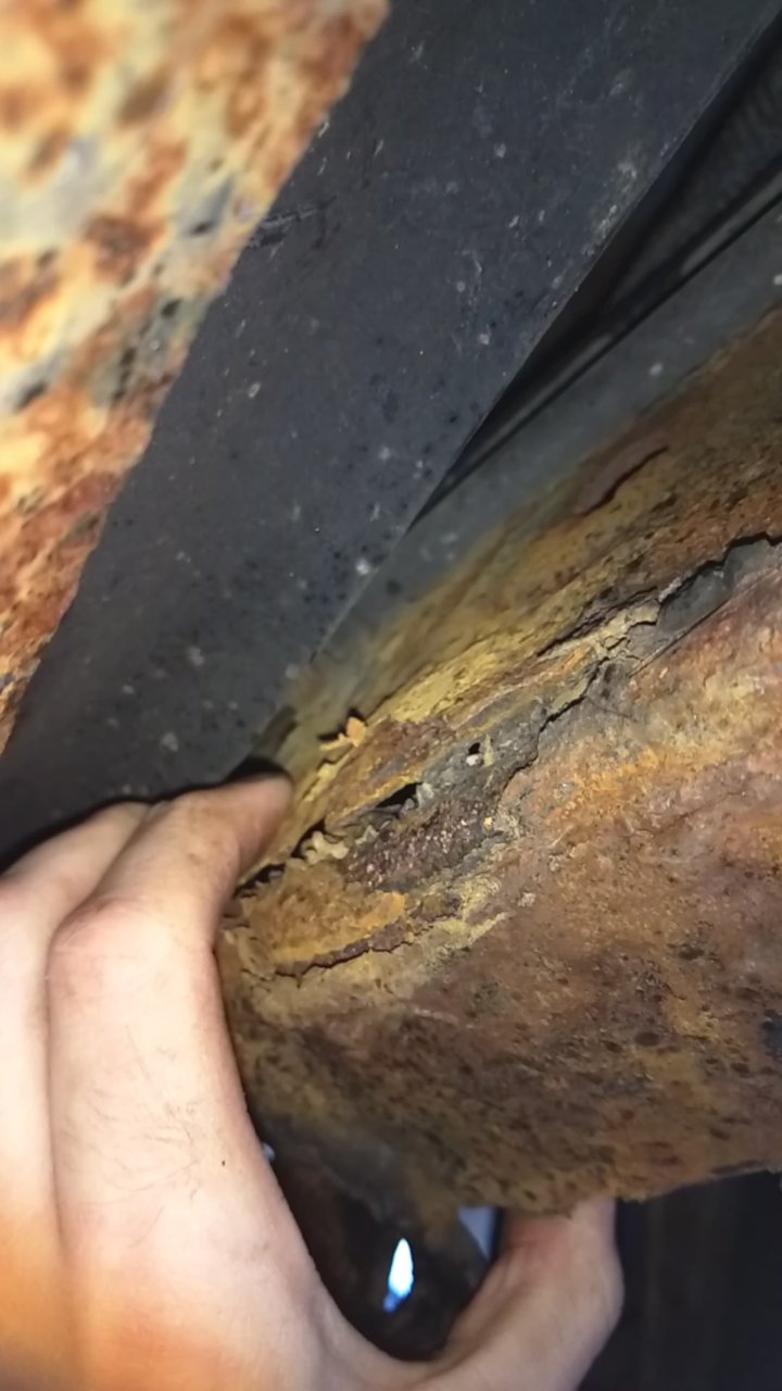

    eh been alright, I guess. As for the truck, in recent times just issues mostly. Leaf spring broke at the eyelet from just daily driving. No idea about that. Thanks AP for nothing. Replaced with Dakars and lift shackles, which is not only a better ride but puts the rear at a better height for the shocks. So that set me back, having to replace. IMG_20190307_082720901_HDR.jpg Frame being the biggest issue now. Gonna need to do repairs on it, once I get the funds. Doing it before the winter was ideal but couldn't swing it. This is just a screenshot of a video where I'm flexing it by hand.Screenshot_20191215-024359.jpg On a brighter note, I'm on 33s now. Ride nicely, I must say.IMG_20190819_080057980_HDR.jpg

    That’s some rough frame damage...

    Probably will need to safe t cap it right? Or just frame swap like @Lux and @Sofatank.

    Yeah the damage accelerated very quickly over last Winter especially. Wasn't great prior, but afterward, it was a marked difference.
    Man, how I wish the 1st gen had a recall and not that voluntary safety campaign BS. The original owner didn't have it inspected, so I am SOL there.
    Saf-T-Cap is the plan. There are some other not-the-greatest areas farther up the frame, but nothing even remotely like it is near the back. Obviously, I'm not thrilled about having to cut up and patch the frame, but the Winters recently have outdone my bi-annual frame coatings and annual fluid film/internal coatings =/

    Frame swap would be optimal if you have another daily, but its a big mess and you'll need to source a beater to get a frame from which isn't easy (especially the unicorn we found), its nearly impossible to find the frame alone around here. but those safetcaps seem interesting. I think when my frame inevitably bites the dust one day Ill just jump right to a frame swap, if you break it down its honestly not that bad.
    How long did you have that leaf pack sente?

    I would love to just switch over to a healthy frame, but that's not feasible for me really. First off, like you mentioned, ya gotta have another daily. I do not. Also, I live in an apartment complex now and so I can't have 2 disassembled trucks sitting in the parking lot. While the caps aren't ideal, compared to a frame that doesn't also have other wear, if they can take care of the worst parts, the rest is on frame walls earlier on the frame. They should be able to be taken care of with just flat steel, should the need arise.
    Had them about 15 months, so I was out of the warranty by 3 months. But I figured I'd contact AP anyway, since it seemed more like a defect than anything else. I contacted via 2 different avenues but neither got any response at all.
