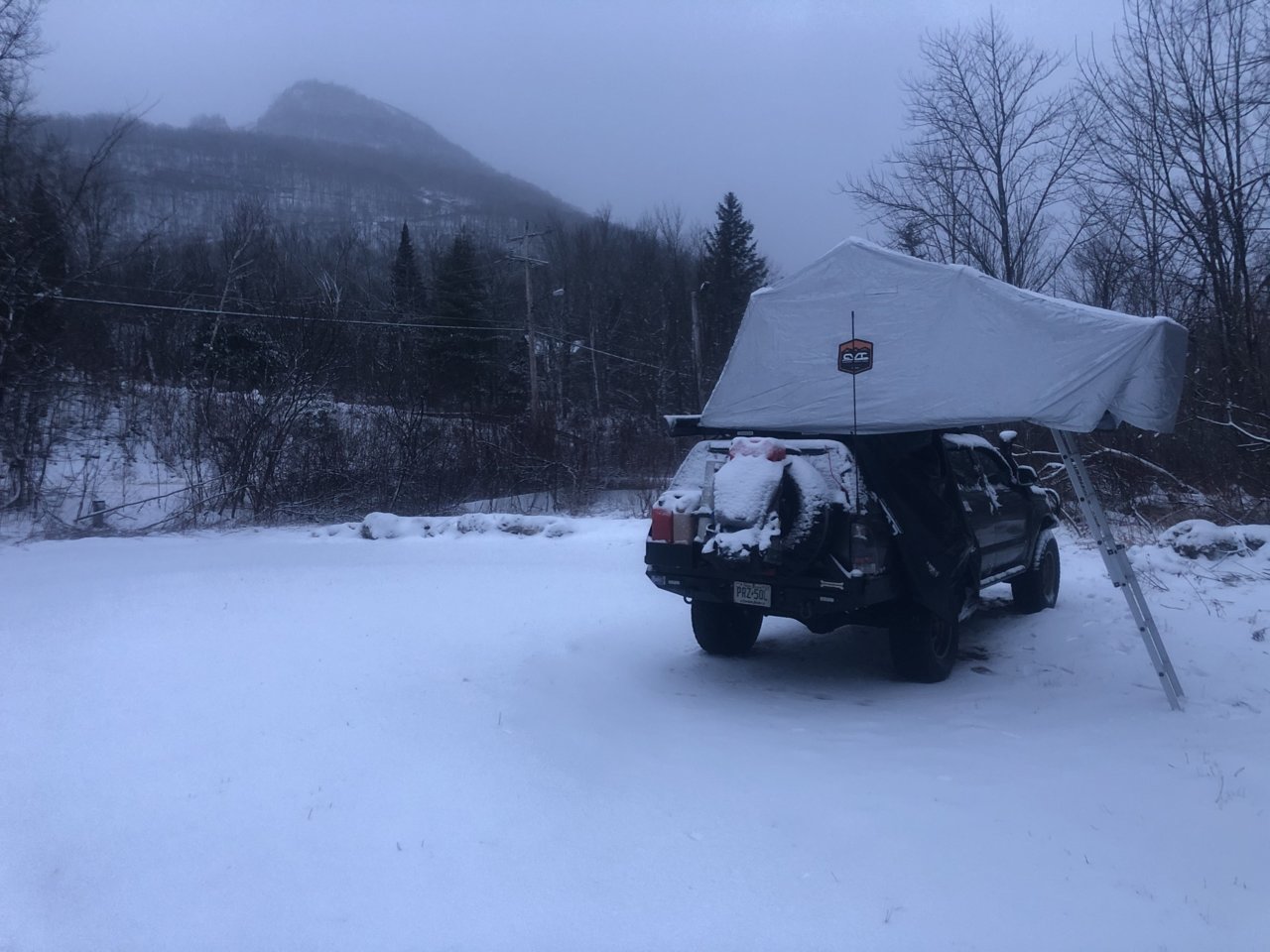

    A couple of years ago, the lady and I spent the night in the Hunter parking lot by the storage containers before a serious storm. Woke up to over 30 inches, then just walked to the lift.
    I will be deploying this technique up at Hunter and other resorts this season, but I don't think I want to be in the parking lot. If anyone has suggestions for Winter camp spots near Hunter hit me with a PM.

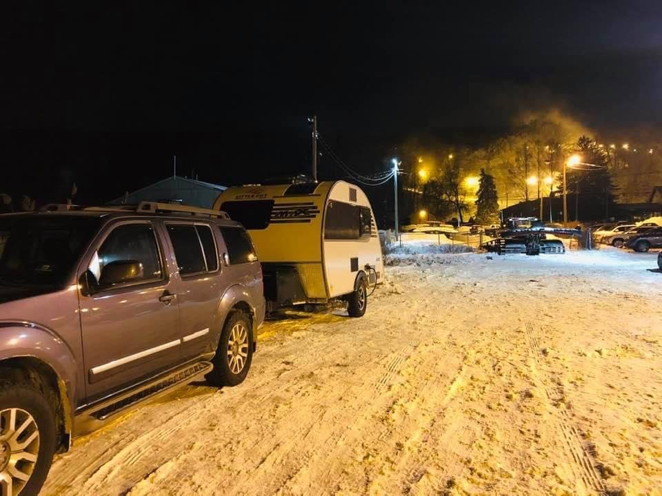

    Mountain creek last weekend. Im getting spoiled with the camper. We stated Friday and Saturday night.
