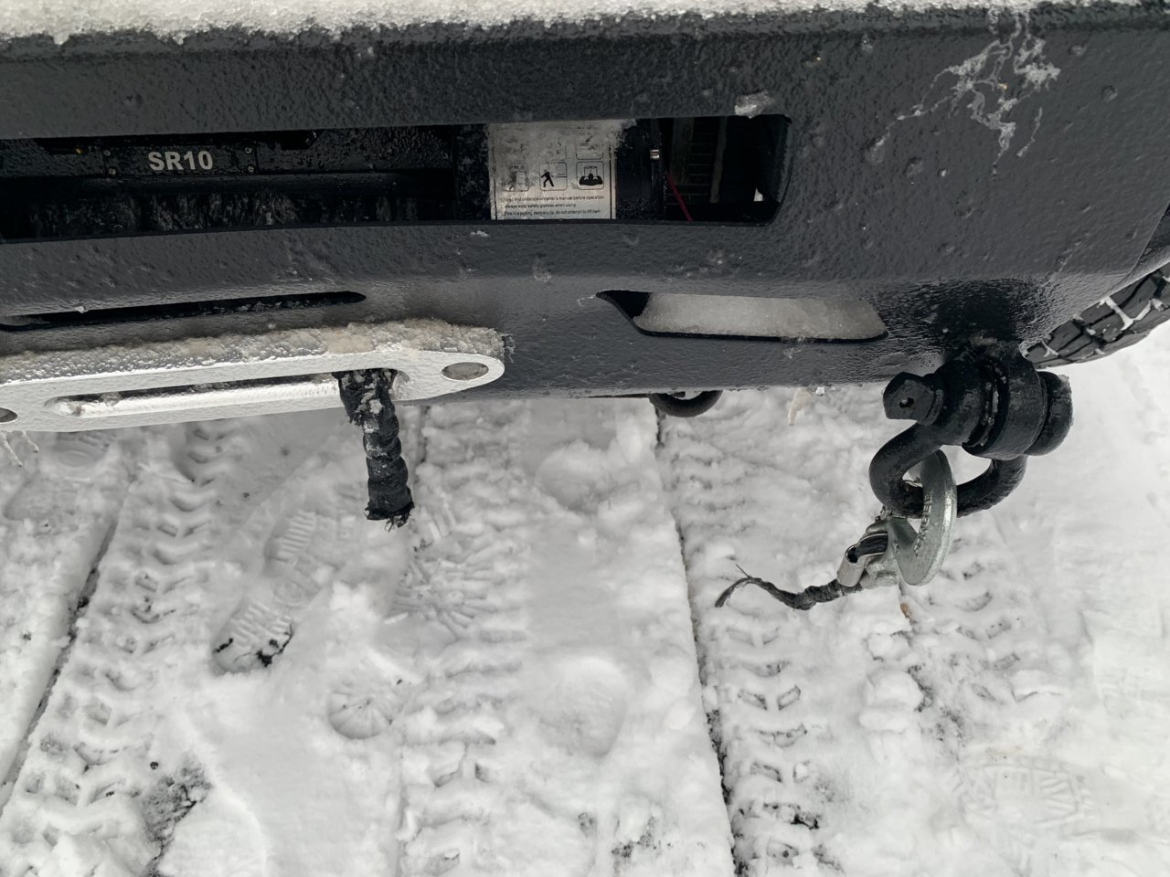

    Anyone have this happen? My winch has a mind of its own... it sucked itself in and snapped itself... never seen this before and never had an issue... i guess Im going to wire a switch to it now.

    #229096
    6,418
    TRD Ferguson
    2016 TRD Off Road (OVTuned)
    Could’ve gotten so cold it decided it wanted to do something. I know electronics do weird stuff when it’s cold or connected to a low battery

    i think it was the installer error... how many beers did we drink that day we installed this thing?

    In the mean time Ive disconnected it from the battery and ordered the factor 55 splicer. I guess now I gotta fix the dent in my bumper.

    this is why I have my winch power running through a disconnect. No key in ignition and switch flipped, no power.

    Whered you end up mounting the switch? I have a switch I can use just never installed it. Winch has been on the truck now like 3 years first time this happened. Quite crazy. It bent the recovery point itself. Its obvious it bent the plate no problem. Im just mad I now don’t have a winch unless I tie a bowline in the end in an emergency but the fid should be here saturday and Ill splice it back together.

    the switch is in the cab, and powered via an acc hot.

    Yep.
    https://www.bluesea.com/products/9003e/e-Series_On_Off_Battery_Switch
    This is the disconnect switch I used. Mounted in the engine bay, just forward of the battery.

    Isn't there a story/post somewhere of an FJ that burned to the ground in the owners driveway from a short. The winch engaged itself and tried to draw the line in till the winch itself overheated and started a fire. The way I see it your lucky the line snapped. And kinda amazing it did given the breaking strength of the line and how much force was applied to do so.. I’d be happy you still have a truck
    And you don’t need a fast fid to splice the line, it just makes it easier.
