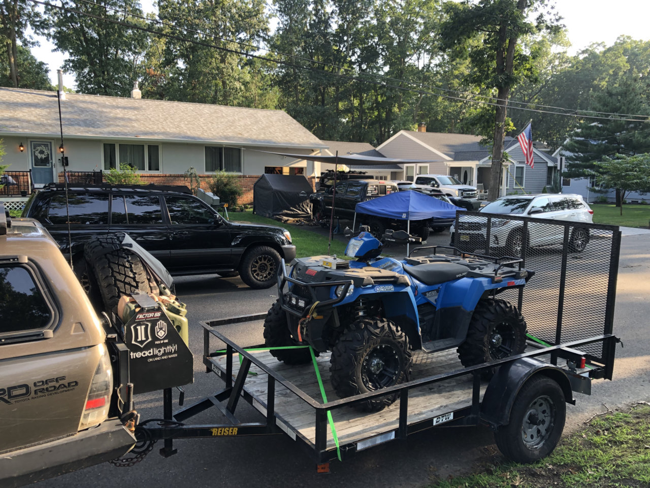

    Click on my Build
    It’s a rental don’t be gentle :D
    @JLink
    cynicalrider, MY50cal and uurx like this.

    @JLink your makeshift car port is legit.

    Yep.
    Looks like a little grow room in front of the Taco :spy:
