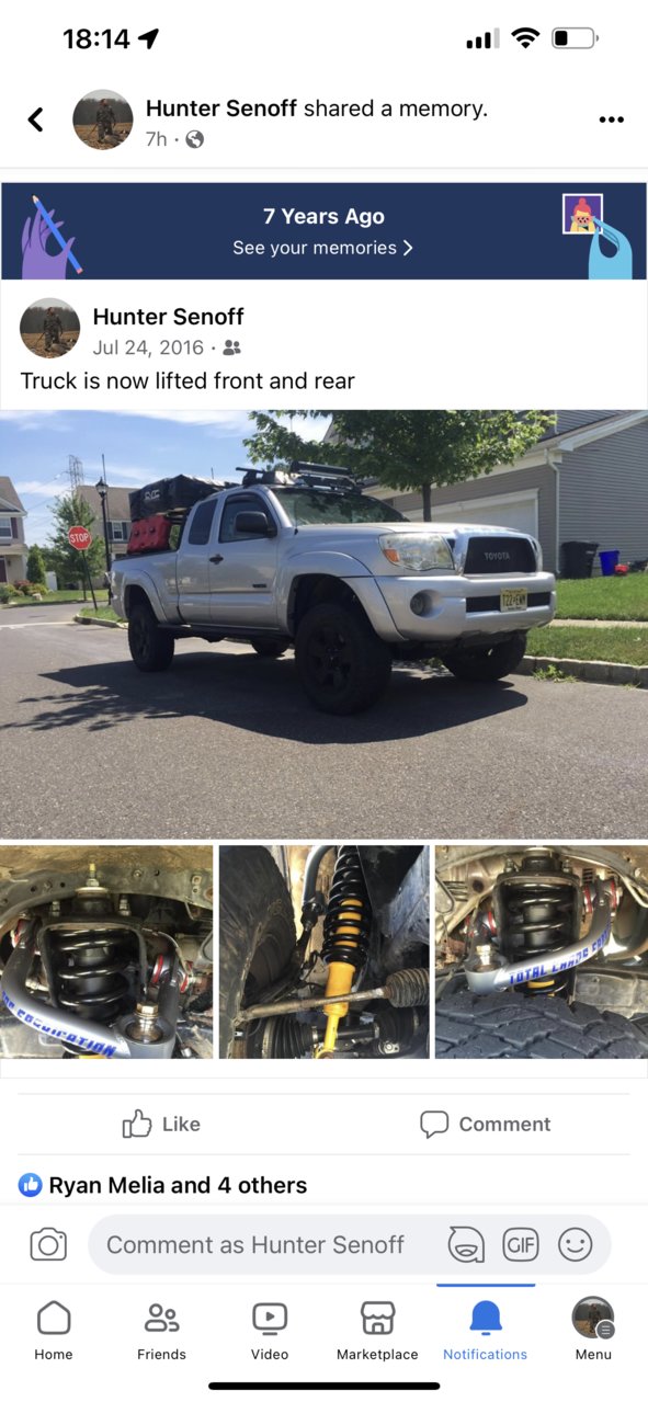

    7 years of driving on that suspension. 7 years and only 1 of the eccentric bolts was siezed into the bushing.

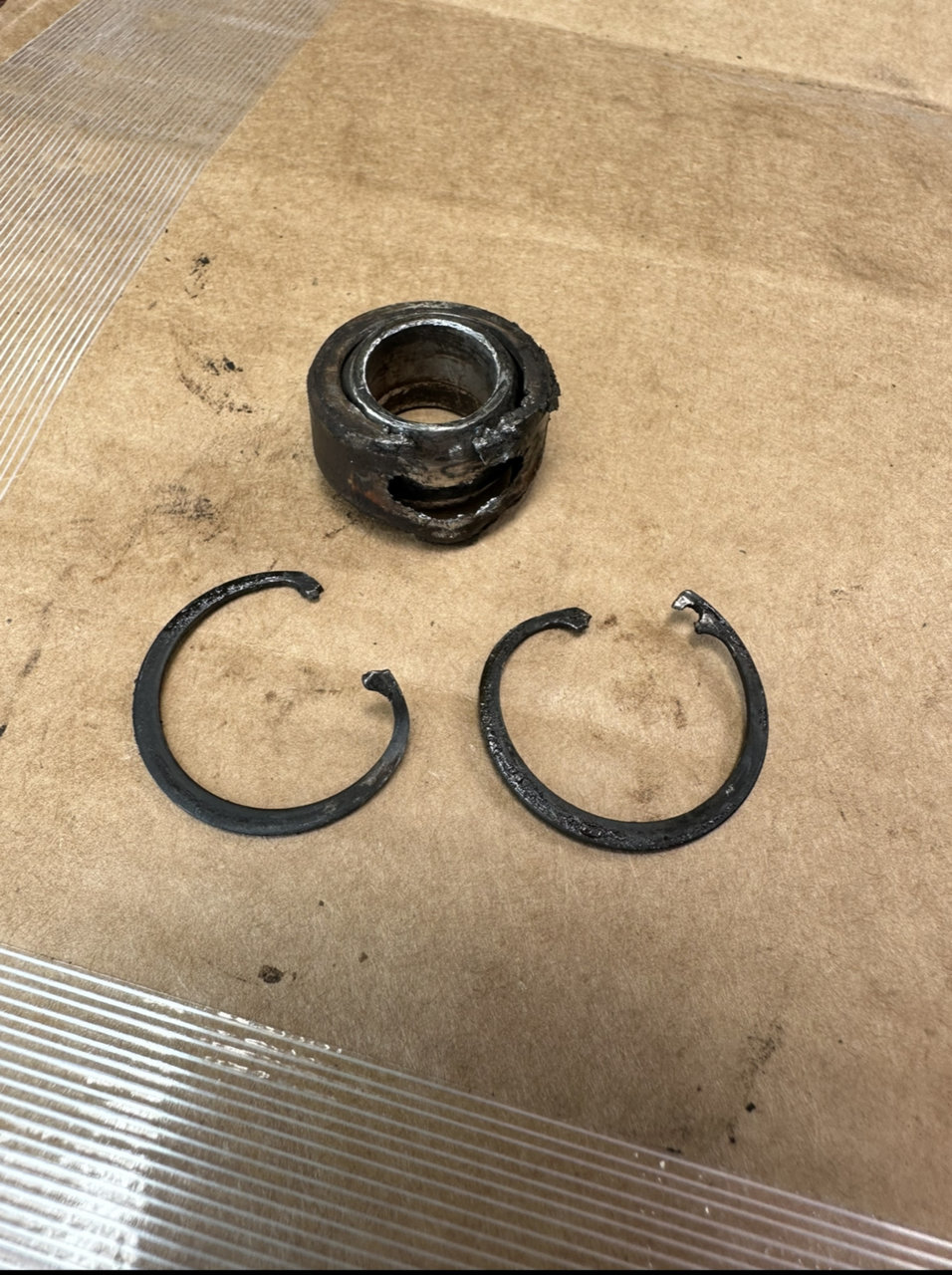

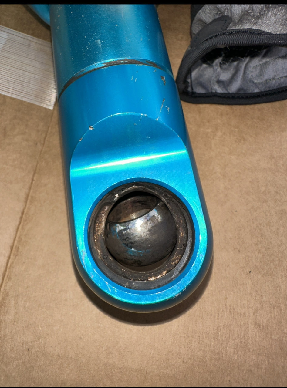

    Nice. 7 years vs mine approx 2 years1 year since last rebuild

    Those look like the regular steel version of that bearing guessing by looks. FK makes a stainless version that might get you some more time between replacements
    I think its WSSX 16T maybe 12t - i don't remember exactly off the top of my head

    Good observation!
    Those bearings came in a kit I bought online from… I can’t remember the place, but they sell rebuilt kits for some shocks.
    This time around I used King SS bearings I got from Summit a little while back. Still have a couple of FKs left, maybe for rear shocks (whenever I’ll get around to it)

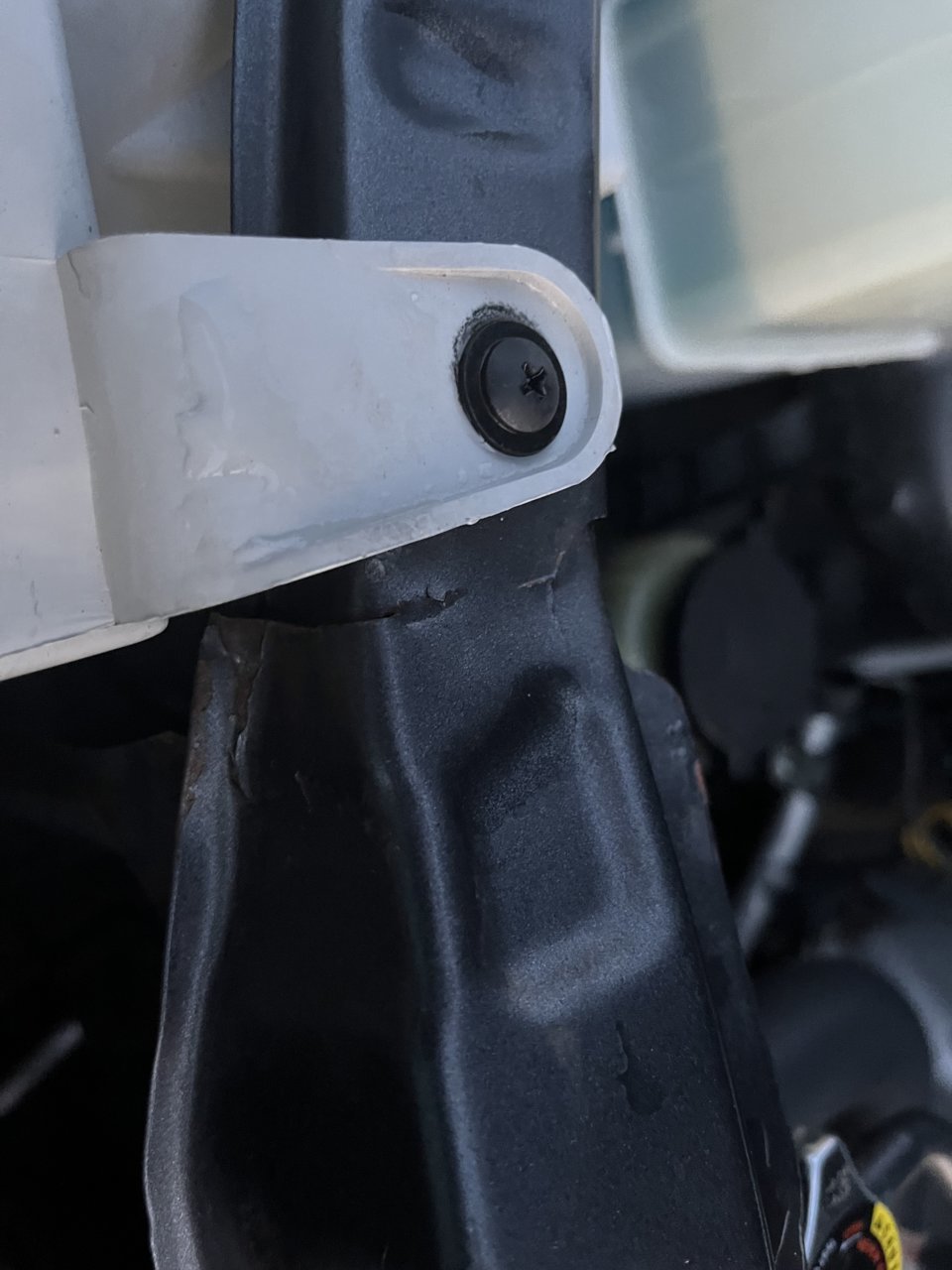

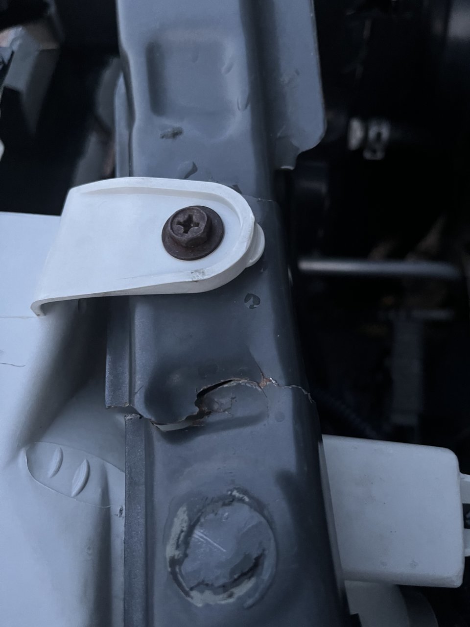

    The old girl has a slightly cracked rad support.:goingcrazy:oo

    Can barely notice it

    Can’t see it at all when the hood is closed.:notsure:

    Gorilla tape?

    I’ve stitch welded mine back together a few times. My headlight support and inner fender all cracked too.
