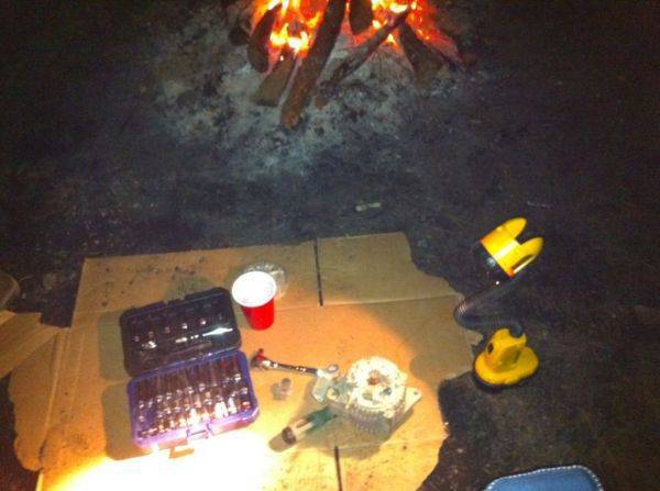

    Yeah, I just took it apart and cleaned off the brushes, let it dry overnight and put it back in. Good as new. Meanwhile Eddie watched as Ant and Scott replaced his for him.
    Only once. I then bought replacement brushes and the control module as backup since that's about the only thing that goes wrong and is far cheaper, smaller, lighter than a whole alternator.

    Did yours stopped working while you were in a water hole or it happened later on?

    Battery light came on shortly after I had been bombing through water. Once we got back to camp checked the voltage and it was low.

    Did you do the cleaning right there and then at the camp or did it make home?

    Fireside.
