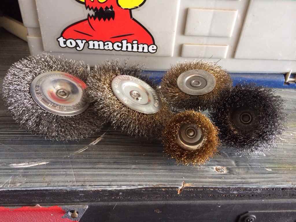

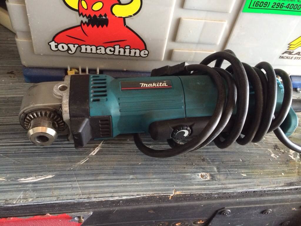

    Here is what used
    I also used a palm sander with 150 grit paper and the flat surfaces

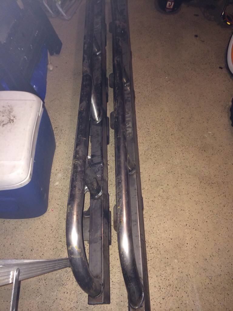

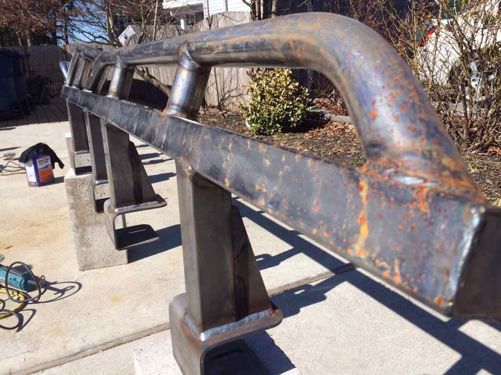

    Was your rust pretty thick or mostly mild? These sliders need a solid bit of refinishing before I can make them look decent. I figure I'll be using a combination of both flap discs and wire brush so I don't risk pulling off too much metal either.

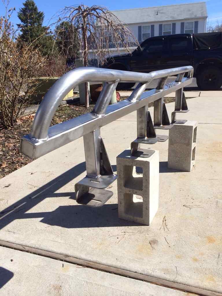

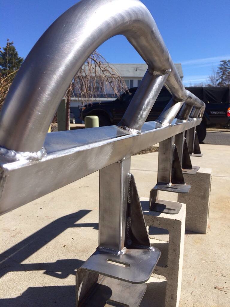

    Before
    zadudepe_693ee1bb1e9e4a54846bb2deeab19afb7c6bf3ba.jpgby5esyge_9aec137c6e75cca15153abf4b0fe3ca69c253623.jpg
    After
