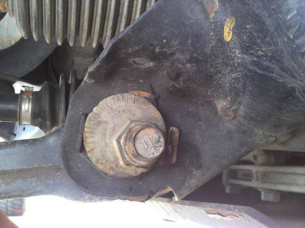

    hey dave .......hows this??? do you do welding at the shop???
    also when i loosen the cam adjusters i loosen the back nut and turn the front "bolt" to adjust....im going to see if the bolt is frozen or if it was just the tab that was bent.......

    it had to be one of 2 firestones....
    either the one in tenn..... or the d.b. in westbury l.i.
    no one said anything...."the guy at the firestone in LI " told me the adjuster was frozen .....he never said the tab was bent.......
    so yyesterday i go under there to check out the front end before the rausch creek meet and i find this.....:mad:
    im gona bend it back and have my friend tack it with a bead of weld.....
    but i want to see if the adjuster is frozen or not.....
    do you see any problems wheeling like this this weekend?????

    I dont see why you cant go wheeling with it you been driving with it like that but yeah get a weld on it
    bet it was the guy that said it was frozen that cam had to be on the
    orther side for that to happen

    A frozen cam will bend that tab as you drive. The alignment cams will rotate as the suspension cycles and will eventually flatten the tabs meant to hold them in place.
    Happened to me too, but I went a little overboard with the fix so it can't happen again.
    Before:
    After:
    Remember that if it bent in the front, it's likely also bent in the back as well. I had a total of 8 of these 3/8" cold-rolled steel plates fabricated and welded in place to keep everything where it needs to be.
