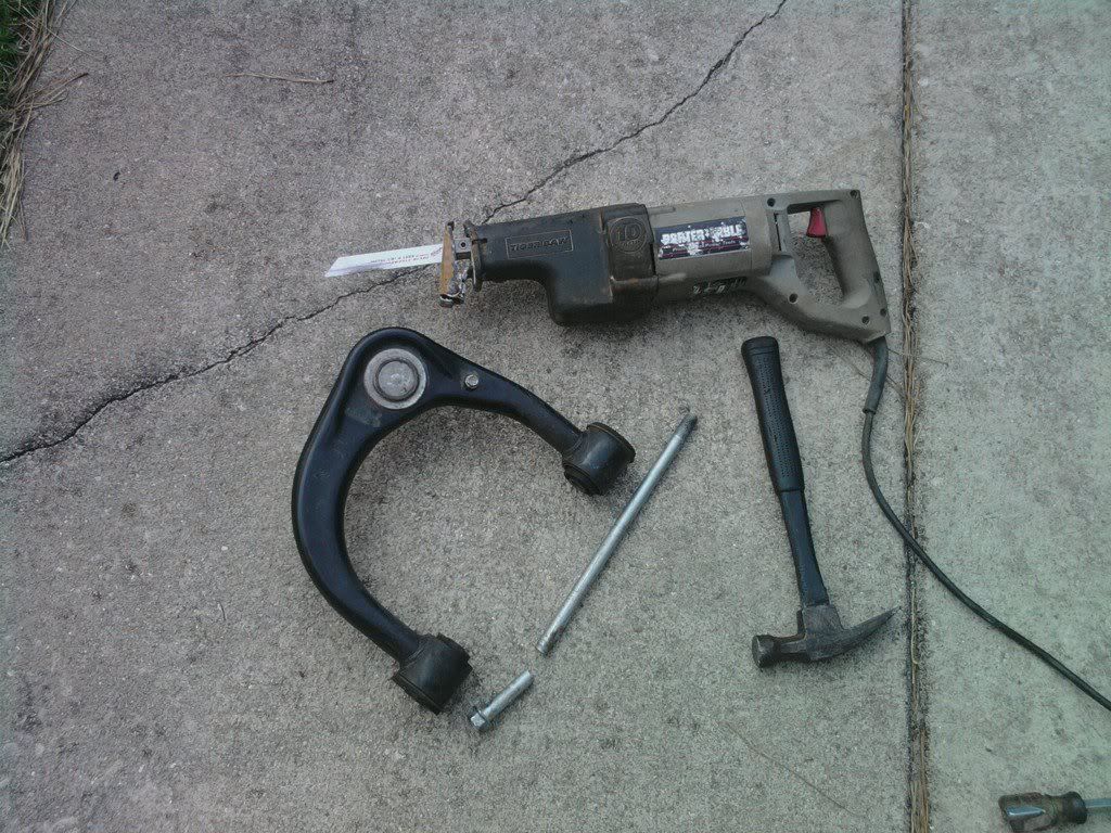

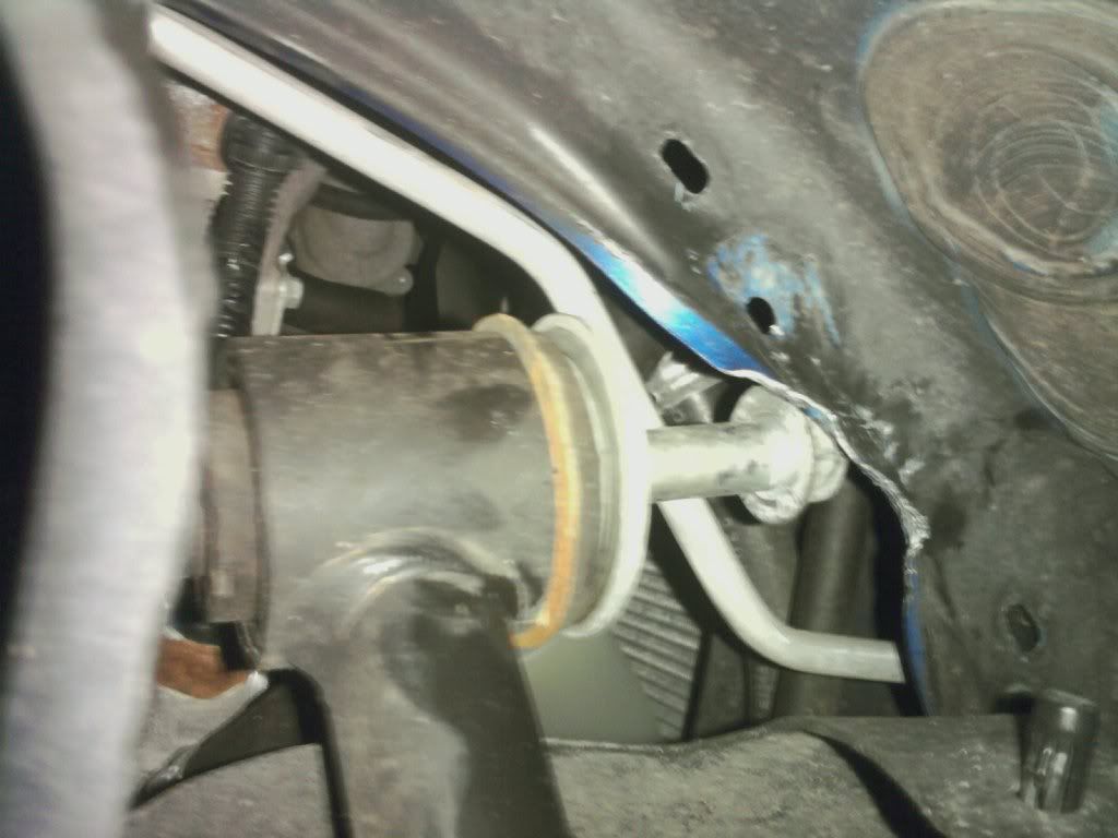

    Yea, the passenger side of mine was a whore knocker. Said f it and cut it out as well. Had an extra bolt on standby for that reason. Wasn't worth the trouble bending the crap out of the sheet metal. Now the bolts are upside down for easy removal. Cough cough .. This weekend.

    I hope I dont end up like this guy

    Save $7 and don't get the nuts. Just bolts will be fine.

    It can still be done without the bolt. It all depends. On my 09, the bolts came right out with minimal sheet metal bending. Worse case is you loosen the cab mounts and shift the cab over a snicker or bend the crap out of the sheet metal.

    fuck buying new bolts. you can do it with the old ones. just don't bring anything that can cut them and you won't have to worry about it!!
