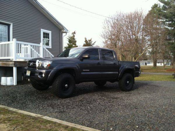

    What do you guys think of this?
    I'm looking for advice/options to get a factory rake (rear high) look.
    I recently installed Toytec-TTHA-CK 3" lift kit, 5100's all around with 620 Eibach springs up front set at .85, TSB 1 1/2" AAL w/2.5 degree axle shims. As she sits now its pretty much level to the eye. When you measure, its approximately 1/2" higher in the rear. Whats my best option to achieve more "rear high" rake?
    Will the new 5100's I just installed in the rear be long enough if I go any higher in the rear? The new 5100's that came in the kit are listed as "extended length 5100's".....
    1 New leaf pack? (I like the Dakars)
    2 Rear block 1/2"-1" to join the AAL?
    3 Other option?

    Did you use the spacers up front to get the full three inch?
    I have the same set up but I had the TBS leafs done with the TSB add aleaf. I did use the spacers they recommended and mine has a good rake.

    My driveway has a slight pitch to it but you can see the truck has some rake.

    Another pic for Sport2012. I took this on this morning I think this is a better picture of the rake, even has 300lb 32" TV in the bed.:D
