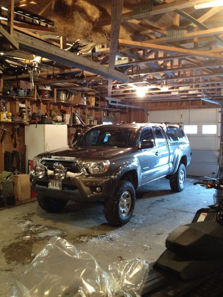

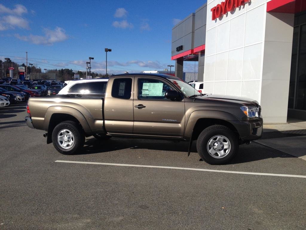

    I purchased my 2015 Access Cab Taco SR5 on December 26, 2014, with 96 miles on the odometer. And I told myself I would keep the modifications to a minimum until it was paid off. Well... maybe until the OEM tires were worn. But, I think we all know how these things go.
    The day I bought it:
    1DE37BE3-D1EB-4CF9-949E-36F67B6ACDBC_zps_abfe37f33767f3e7e169325439c31ce1ae827af5.jpg

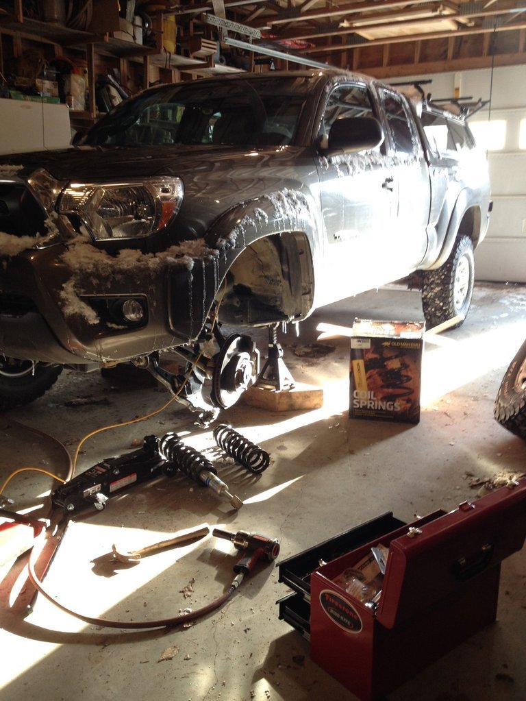

    Not to be antisocial, but I've never been a huge fan of the "Never Wheel Alone!" concept that's pushed pretty hard over on JeepForum. I prefer adequate preparation over relying on others, so I decided I needed a winch. It just so happened that a good friend of mine from Northeast Overland was selling his Rugged Ridge 8.5 and 2" receiver cradle, so I jumped at the chance. Paired with a CBI High Clearance front hitch, and 12V quick disconnects front and rear, it was a great setup.

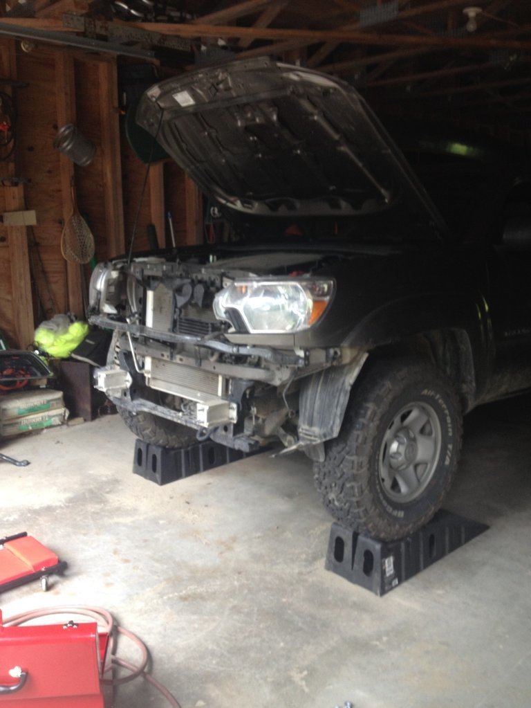

    During installation.
    49B5B9D3-B57A-4432-ACA3-ECFC67276B57_zps_7be013af51d3f24dc55d27176241f2f1483685cb.jpg
    While I had the front end apart, I used to opportunity to remove my OEM swaybar. I can't praise this mod highly enough. The ride quality is a phenomenal difference, both on and off road (especially off road). I've also noticed a very minimal increase in body rolling while cornering, even when loaded for Overlanding. Though, I believe the RideRite's may help with this issue.

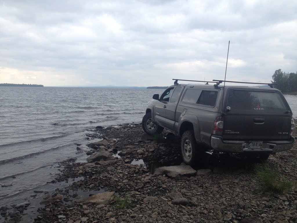

    Then the time came for my first Overland trip with the Tacoma! I spent five days in the North Maine Woods, primarily the St. John Valley, over the 4th of July. Here's a few pictures from the trip.
    However, the rear end rode horrific with the stock SR5 shocks and the RideRites inflated to level the truck when loaded for wheeling. So, new shocks were in order. Which obviously turned into new suspenion. I ended up running Bilstein 5100's in all four corners, with the front set at 1.75". For the rear end, I added the Wheeler's HD Progressive 3-Leaf AAL kit, which netted ~2". I also added Daystar air bag cradles, so downtravel wouldn't be limited by the bags. It was great setup, though the ride and load capacity of the front end once the winch was mounted left something to be desired. Anyways, here it is with 1.75" Front/2" Rear.

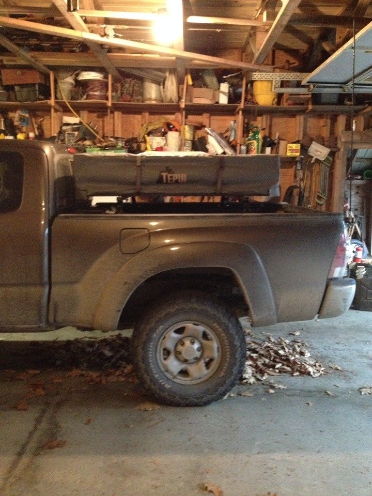

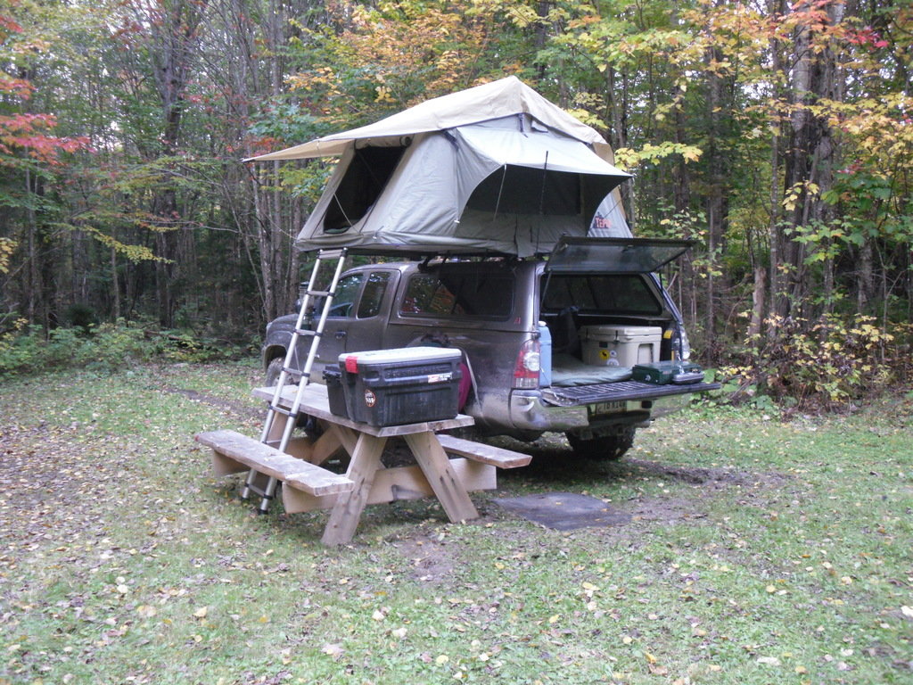

    Then I bought my beloved Tepui Kukenam! I mounted it to the Thule load bars, which I'll admit I had my doubts about. However, after some spine-jarring bumps that would've ejected OEM bumpstops through the frame, the tent and bars remained rock solid.
    The day I got it:
    C0A3153D-8164-4655-98DE-133EABF80DAF_zps_057b5ee20eb37a6cb85cbfaebf5e004089ef03e7.jpg
    Two days later:
    I can't praise the tent highly enough. I can't believe how well the thing retains heat. Unlike any ground tent I've ever used. We woke up to a brisk 17* at our first morning, and the tent was at least 15* warmer than outside.

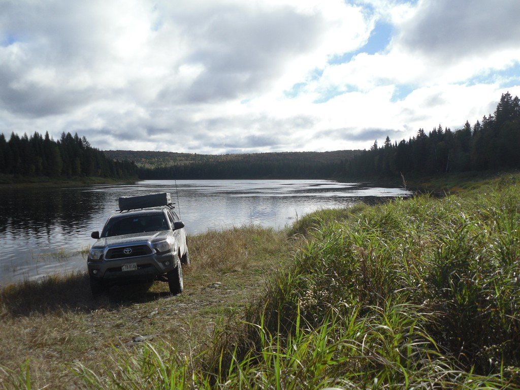

    A few pictures from various hunting trips last fall. I spend every weekend from the beginning of September to the end of November in the woods.
    A buddy and I spent four days in the St. John/Ross Lake area. He limited out every day, and I limited the last two. (I'm the guy on the left)
    All in all it was a fantastic season for birds! All of the regional guides were claiming it to be the best year in the last decade.

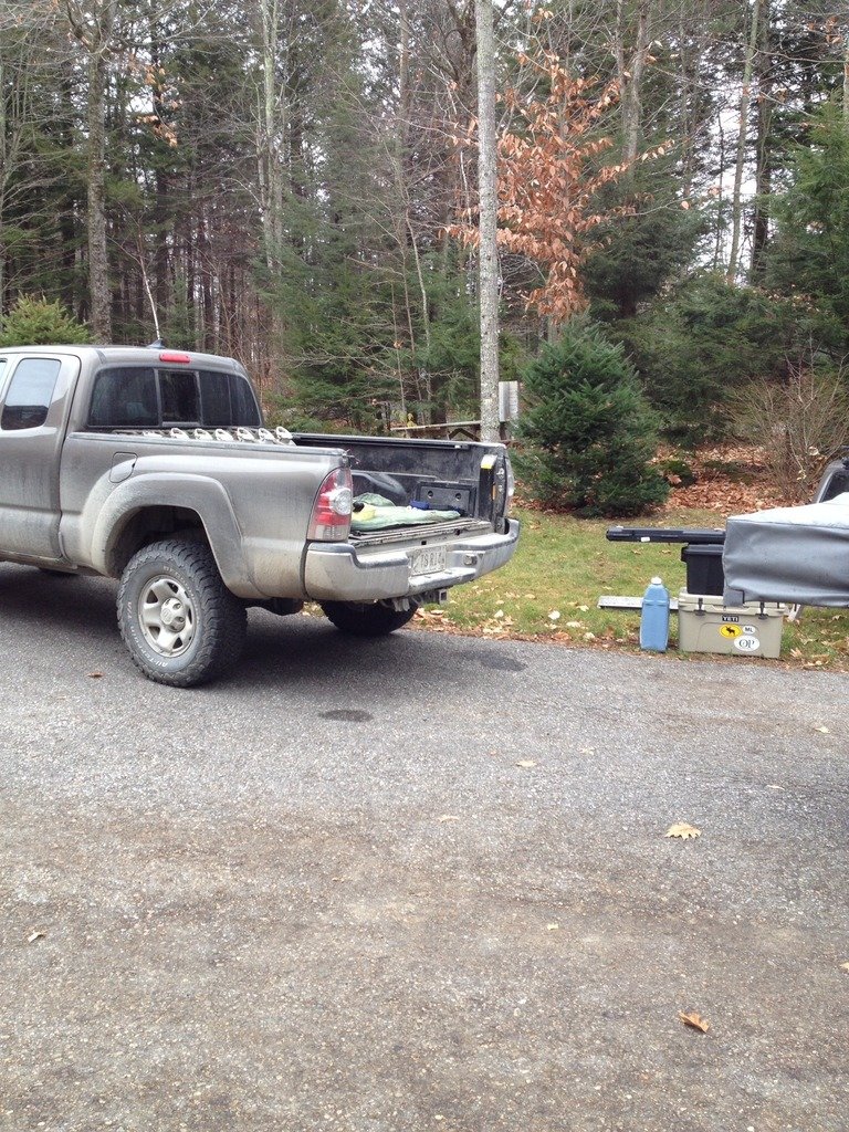

    I also made my last trip of the year last weekend (Nov 28-29). Went from Moosehead north to Round Pond by Allagash, then north to the St. John. Came out through Ashland on Sunday.
    Tried a different setup for the trip. I'd been wanting to try it all season. I removed the cap and mounted Thule bars to the bed rail system. I do miss having the RTT up high, but it's so much easier loading/unloading the bed and setting up/taking down the tent. Here's some pictures of the setup:
    290AFEA4-AECE-4035-B5EC-E4446A1E9BAB_zps_b4814b970a4da41d4c051ef272eb7411b1a8348a.jpg
    9B1EF767-3796-44F5-8D4D-79E3F604F626_zps_98c5217c447229f045dcae70856151b2e5c2abf2.jpg
    3E8D5283-7FF7-424F-8E9B-327B4D7A91B9_zps_1f0ba80e60ee01b392b56a0a242152a38c7fc1bd.jpg
    EEEA926B-F268-4850-8571-4B02A78B50A5_zps_89009f7b2a06fa01ee2fd85f56b7e6866e501f4d.jpg
    The cap is back on for winter, but next year I plan to run a similar setup using Relentless 8" rise bed bars.

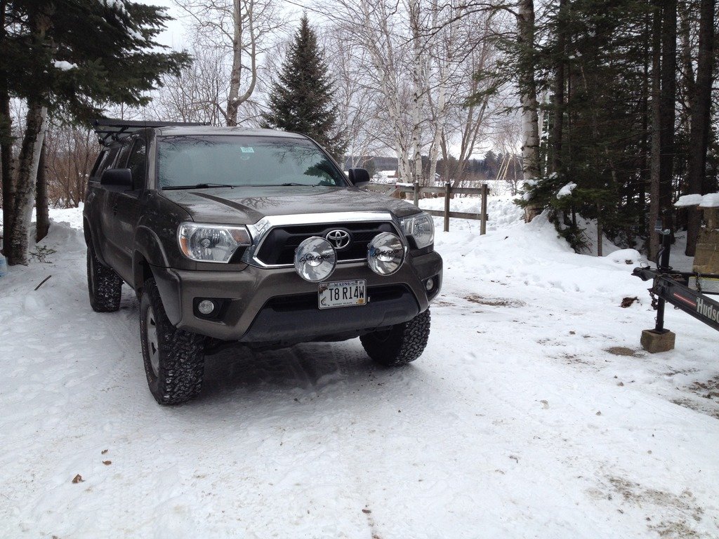

    Afterweeks of research and indecision, I finally pulled the trigger on an ARB Deluxe front bumper/fog light kit.
    Of course I needed to upgrade the front suspension to account for the new added weight. OME 885's did the trick. But, I will be upgrading to 886's this summer.
    I also installed some Lightforce 240 Blitz's. I was pretty undecided on how to mount them, but once I had my mind set on an aftermarket bumper, I decided to just throw them on temporarily. Here they are!
    30C02B97-621B-4D5A-9F1D-E9F66C7CFE94_zps_a21999419ea8ad294000799826b7d9e8594f1590.jpg
    77C66C22-5DBA-4E8E-9AFD-B692D928D96C_zps_3b66cea01a6dbef2baac1d9827cb10e5be878be6.jpg
    These things are stupid bright. Like, melt your face off bright. Cause permanent psychological trauma to nocturnal animals bright. Right out of the box with clear spot filters they're good for 1,000+ meters. My intentions are to eventually convert them to 100w HID. Just for comparison, Lightforce sells a 50w HID 240 series that they rate for 1,800 meters.

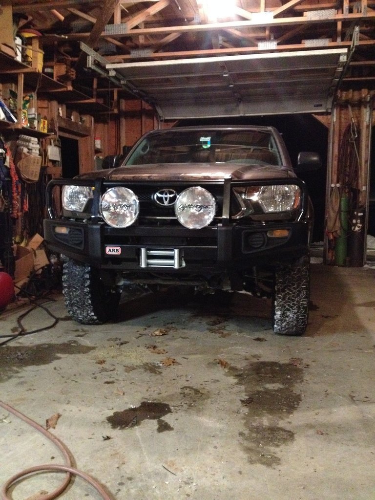

    Mounted the ARB.
    CC862ED7-0A26-4C5F-9A12-EC16503ABB5F_zps_ca5caa7f6b0a28b9854f51fbad75c2995968bd36.jpg
    Getting it on was more of a job than I planned. I ordered a 05-11 Tacoma model, because I don't like the style of the 2012+. I ended up having to do a little grinding on the supports to make it fit on this front end. But, it worked!
    F98AA5A8-8BCA-4425-9265-5AF1CEFA7E42_zps_4ed95d13fa01228892283a84623e5594fe3ec071.jpg
    This thing is a beast. 16 bolts securing it to the frame.

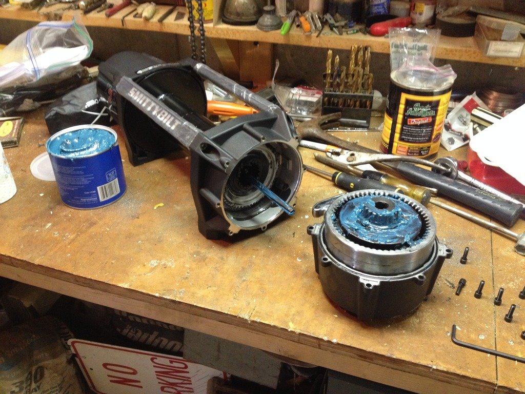

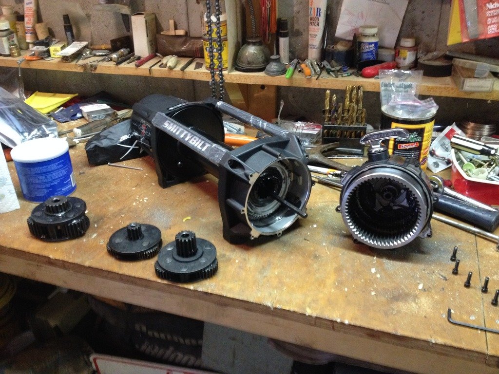

    Decided to upgrade from my tired Rugged Ridge winch:
    392C22AC-431F-47D1-964A-DF9485B77A1A_zps_c6fe1d12fdd08a9dfba4317a44a0330ed7c5bdfe.jpg
    Pulled, cleaned, and re-greased the planetary gears with bearing grease for easy free-spooling.
    13B43B3D-2CA3-41B1-AD2A-9AA5BDE4B107_zps_1aee8e1875f25264a02bbb6cf3ef46f33cdb1dad.jpg
    AD3B8D08-2389-4DE2-AD4E-0295FEE2D5A3_zps_e195099771c4d5b8f50db8b7c2a116d3300495dc.jpg
    The winch free-spools super easy. You can literally pull it with one finger, uphill. Awesome mod.

    Stumbled on this build from your insurance question thread. Truck looks good! I dont suppose you have a best guess what the ARB Bumper weighs? I've heard a wide range on it
  20. Mar 1, 2016 at 9:31 AM
    #20
    NMW 4x4
    NMW 4x4 [OP] Wheels With Moose.
    Sep 22, 2012
    #87462
    563
    Walt
    T8 R11 WELS, Maine
    '14 DCLB SR5 4x4
    Thanks!
    I heard a wide range of weight's too, everything from 80 lbs. to 220 lbs. :der:
    Total, it weigh's about 130 lbs., without a winch.
    The mounting plates are ~30 lbs., and the bumper is about 100 lbs. I mounted it by myself, and had to lift it on and off the truck multiple times until I got the fitment dialed in. I'm 5'6", 145 lbs, and I could move it no problem.
    jztacoma[QUOTED] likes this.
