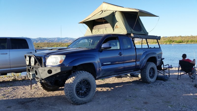

    just stumbled onto this.
    Love the pictures.

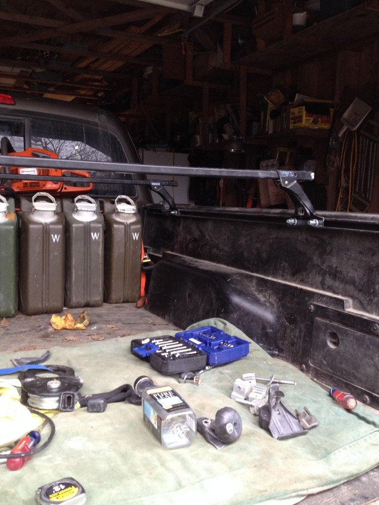

    Those thule bars strong enough for the tent?
    3E8D5283-7FF7-424F-8E9B-327B4D7A91B9_zps_1f0ba80e60ee01b392b56a0a242152a38c7fc1bd.jpg
    any problems?
    what model thule bars are they?

    I've never had any problems with the Thule bars. I'm not sure what model they are, just the standard load bars that work with the artificial rain gutters.
    I will say, even though I've never had any problems with the above setup, I would not recommend it. I would go with Relentless bed bars. The Thule's are fine on top of the cap, but when you mount them on the bed rails the feet are spread too far apart and the bars sag from the weight.
    I only ran that setup for one weekend and put the cap back on.
