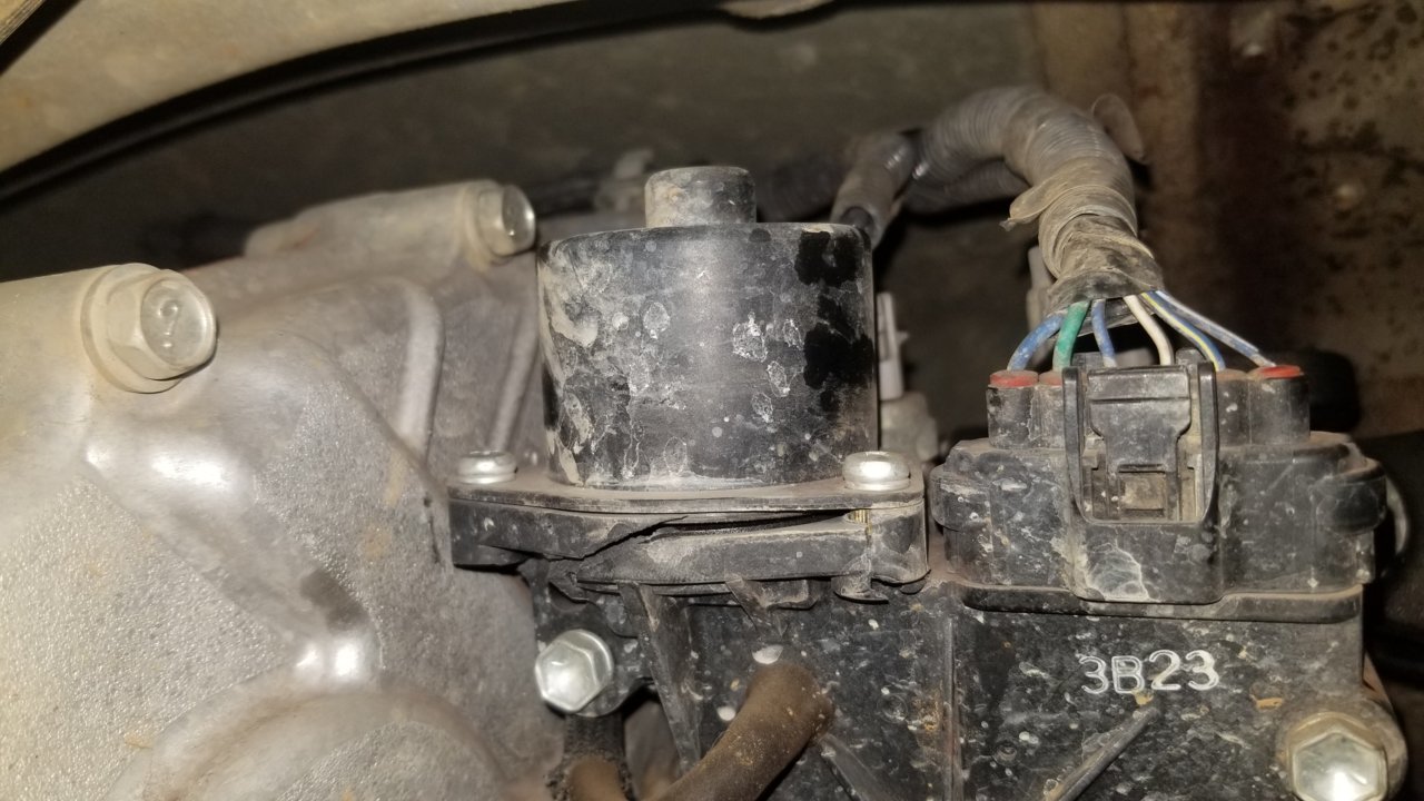

    Hello everyone. Was going to create a post but, this post is a similar issue.
    My 4wd and 4lo light started flashing while driving home in heavy rain, never tried to engage the system. Surfed the forum and did everything suggested, with no avail. It turned out to be a corroded connector going to the ADD. A new pig tail cost $24, the pig tail goes from the actuator motor and connects to the wiring harness. The connector going from the wiring harness was corroded to.
    I cleaned up terminals and used some dielectric grease and it seemed to fix the issue.
