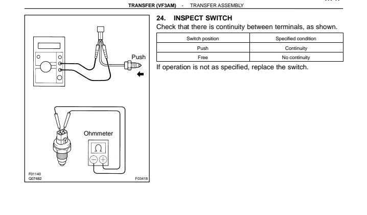

    Does your truck have a transfer position indicator switch on the transfer case? If so, and if it's bad, it won't relay to your 4wd ECU that you're in 4WD (even when you are), and therefore the light won't illuminate.
    Pulling the transfer position indicator switch from the case is real easy and it should have no continuity when fully released but have continuity when the end of the switch is depressed.
    Edit: found a pic of the testing procedure

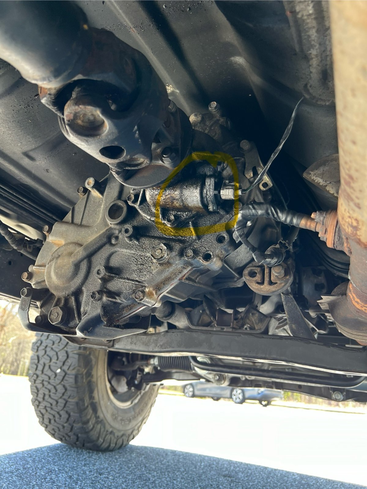

    I don't think so. Pretty certain that's the actual 4wd actuator. Should be on the driver's side of the Tcase, up high IIRC.

    do manual hubs have actuators? i thought only ADD had them. I will keep looking on the drivers side

    The front diff does not (on a manual hub truck), but the Tcase still does. ADD trucks have both a Tcase and diff actuator

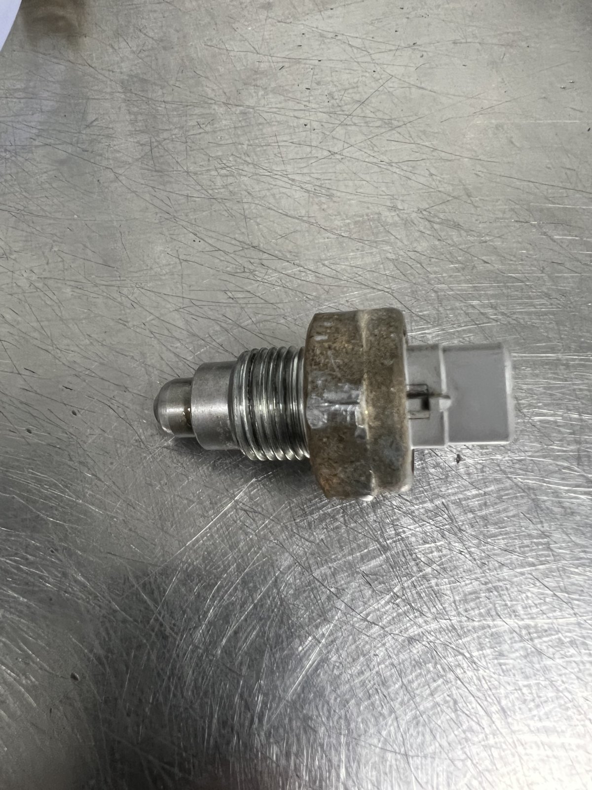

    So what pulled this one from the drivers side and the continuity test was good. Is there multiple ones? IMG_6632.jpg

    There are 3. 2 on the driver side, 1 on the passenger side. I would test the passenger side and the forward switch on the driver side.

    looks like from the diagram the additional 2, for 4 LO and N, are only on the automatic transmissions

    Your "J-shift" case does not have an actuator.
    The case has multiple switch locations for various setups/systems.
    That being said, the same type of switch is used in many spots from rear locker to front diff. I have seen them test good "on the bench" yet still not work installed. I attribute this to some range of motion difference between pushing the plunger by hand vs what happens when installed.
    I have also seen one test bad then good after smacking the plunger a few times.
    On another occasion a reverse light switch was testing good on the bench but not when installed. I installed it without the crush washer and this provided a little more "push" on the plunger. It worked fine for a few more years before finally giving it up.
    Just something to keep in mind.

    ahhh. i see now. im an idiot, i had taken out a switch on transmission. I see the 4wd plug now, i only have one on the passenger side. kind of in a bad spot to remove so i put a meter on the ends and it only has continuity in between 2H and 4H. pretty tell tale sign its bad i would assume. now i just got to try to get it out to put a new one in
