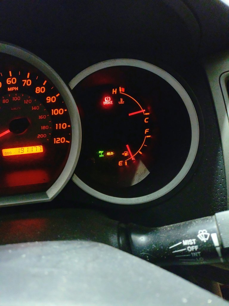

    So I got a newer motor into this truck, after fixing the broken engine mount perch...
    4x4 and 4Lo dash lights flash when i attempt to engage.
    I believe that i forgot or damaged an electrical connection.
    Any clue exactly where i missed a connector?
    Thanks
