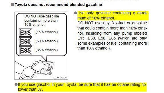

    Will it work? Yes. Will it reduce life of components? No way to know for sure. Do what you want but I don't gamble with my Tacoma's lifespan just to save a few pennies.
    Here's what it says in the user manual. 85 octane is no bueno. More than 10% ethanol is no bueno. @essjay made the right choice in selecting the 88 octane with no ethanol out of the available options.

    Blame? I'm not blaming anyone. This post is about what octane & ethanol combinations are best for our truck. Since 88 octane no ethanol is available in the original photo that is the best choice if following Toyota's guidelines in the manual.

    I see now OP edited the details to confrm the choices were in fact "up to 10% ethanol". So in that case the 85 octane 10% ethanol, even though it doesn't conform to the manual, would have likely worked and been OK at altitude but possibly suffered if you drop down to lower levels. Either of the 88 octane choices are better for the user manual guidelines but at elevation not 100% necessary due to how air/fuel things work. I still wouldn't but that's me.
    Personally if given the choice I'd take that 88 octane no ethanol all day every day. I'm not sure you'd get the extra $5 in cost back in fuel mileage but it's possible. On a road trip out west about 5 years ago in a tiny little Ford Focus I was getting about 2-3 mpg better with non ethanol than 10%. Assuming you can fit 17 gallons in an empty Tacoma tank if you got 1 mpg extra it might cover that cost.
