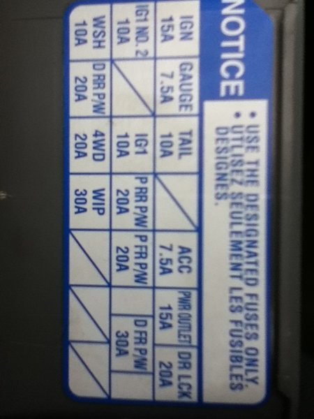

    Hmm IG1 has those, but if the headlights work that doesn't make sense
    IG1:
    ABS (w/ VSC), TRAC, VSC, Auto LSD, Downhill Assist Control and
    Hill–Start Assist Control
    ABS (w/o VSC)
    Accessory Meter
    Air Conditioning
    Back–Up Light
    Charging
    Combination Meter
    Cruise Control (1GR–FE)
    Cruise Control (2TR–FE)
    Electronically Controlled Transmission and A/T Indicator (1GR–FE)
    Electronically Controlled Transmission and A/T Indicator (2TR–FE)
    Engine Control (1GR–FE)
    Engine Control (2TR–FE)
    Headlight
    Multi Mode 4WD and Rear Differential Lock
    Power Outlet (115V)
    Rear Differential Lock (2WD)
    Seat Belt Warning
    Shift Lock
    SRS
    Tire Pressure Warning System
    Trailer Towing
    Turn Signal and Hazard Warning Light
    Newlife, theboy12[OP] and EDDO like this.

    Ig1 or Ig1 no.2 under the dash

    IG1 or IG1 NO2 Fuses.
    Use a meter to check them or just replace them with known good fuses
    Visual checks are not trustworthy.
