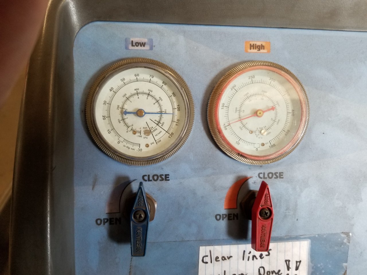

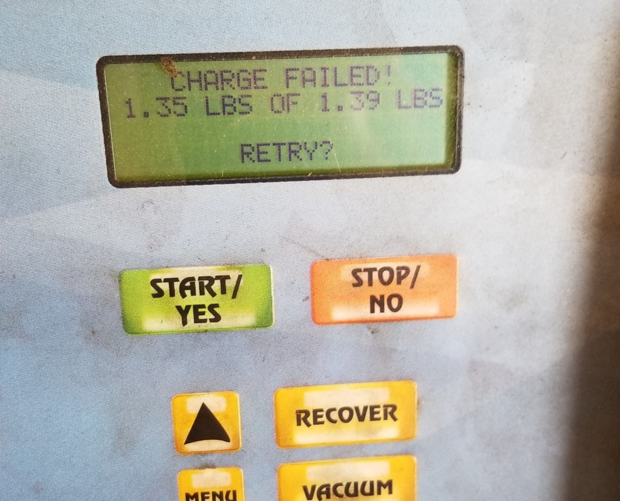

    I have a 2006 Toyota Tacoma base model and 4.0 L compressor no kicking on but it turns. No cool air all hot air thought it needed to be recharged but when charged turned it on a high pitch noise came out and no cool air would come out. Anyone know what it could or what it is

    What are your gauge readings?
    High side pressure
    Low side pressure
    Ambient air temperature
    Duct temperature

    This is what I got on the gauges when it got charged up and would not go down on the pressure on low started it and wouldn't change Bebop
