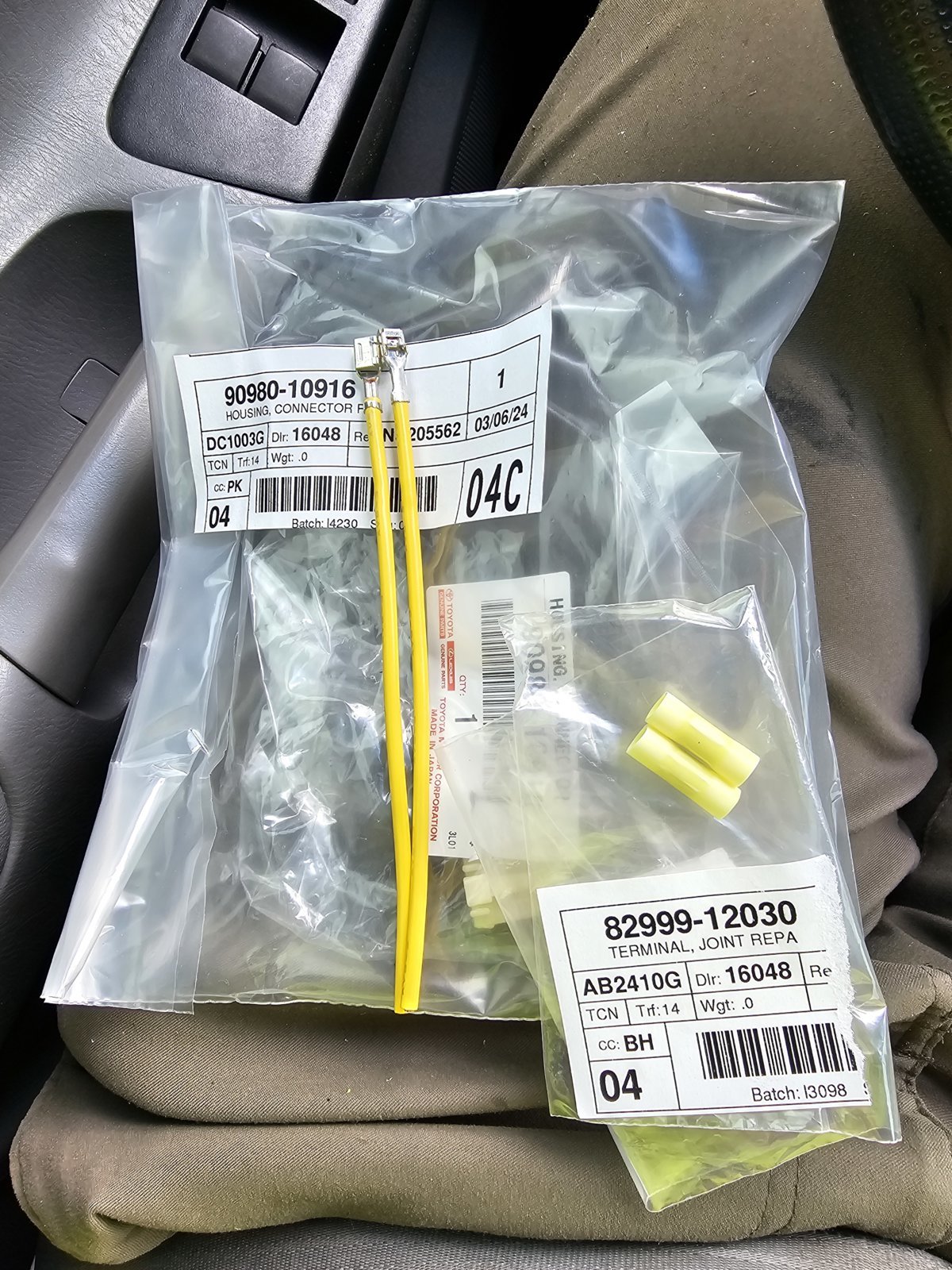

    I just came out of toyota. Figured I'd stop in while I'm in town. $30 for the plug and prongs. I'm just going to do that. After checking Amazon, I'm afraid for how cheap they are they will be junk.

    They sold me the plug, joints, and the 2 wires. For now. I just want this fixed. However, they told me it's the resistor that causes this issue. They updated it and the plug. They told me it was $48 for the new resistor and then 20 something for the pigtail. Once I pick it up, I will post those part numbers. I wanna give back to tacoma world. @Dm93, @TnShooter, and @gearcruncher have really given me a lot of insight on here. It's time for me to give back in return.

    Can't read the bottom part number.
    I have the part numbers for the updated resistor and pigtail posted already.

    That other sticker is the same as the one by the wire plugs
