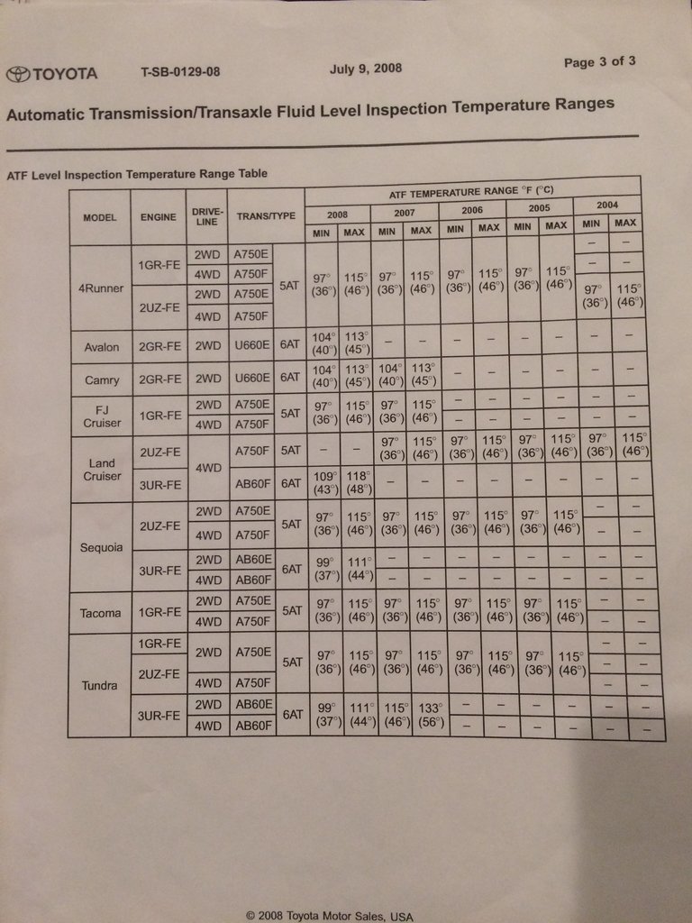

    Top page is for my truck. May not be exactly for yours.

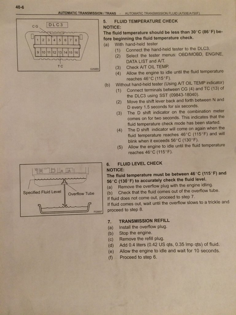

    My truck is a 2009 Tacoma Prerunner 2WD V6 Automatic I think it's a 5 spd....
    I sure wish I had a photo of the tech manual ATF section for my truck... Got one? Anyone?
