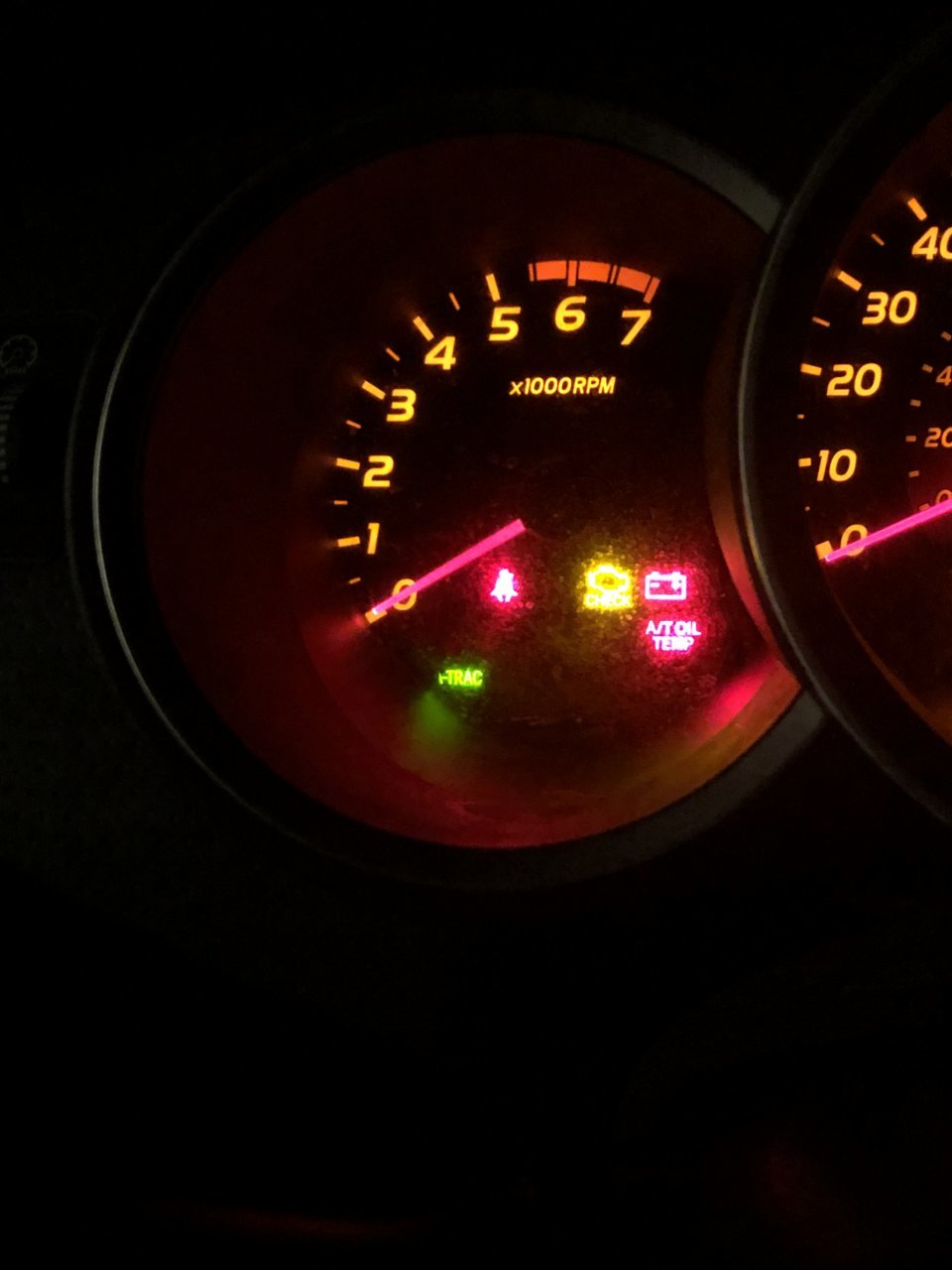

    Hey folks this actually my first post on here after weeks of snooping. I have an 07 trd off road. When I turn the headlights on the atrac light illuminates on the dash (2H,4H, and 4Lo).I have no atrac button but I do have the stock locker switch. It’s been like this since I bought it last month.
    Has anybody else experienced this?

    The electronic aids, A-Trac and Auto LSD / TRAC started in 2009. Yours must be an off-road, if you have the locker, but none of the Taco's in your year had A-Trac.

    From what I’ve learned it’s a common misconception that the aids didn’t start until 2009. See this thread for more information. http://www.tacomaworld.com/forum/te...-trac-hac-dac-alsd-explained.html#post4388605
    check out the light in this picture

    Do you have any input on what an atrac light is doing on my dash...only when I turn the headlights on?

    IIRC buried in the factory service manual (FSM) (circa 2005-2006) are a few electrical wiring illustrations and diagnostic information for ATRAC. I need to dig a little more as there were some traction control and stability stuff that became standard on '09+ but could previously be had as options. And that light appearing on your dash may suggest that you actually have one of the options.
    Otherwise, it begs for an answer as to how a 2007 got a functioning ATRAC light on the instrument cluster?
    Just for fun, can you take a picture of you brake master cylinder unit in the engine compartment and post it here?
