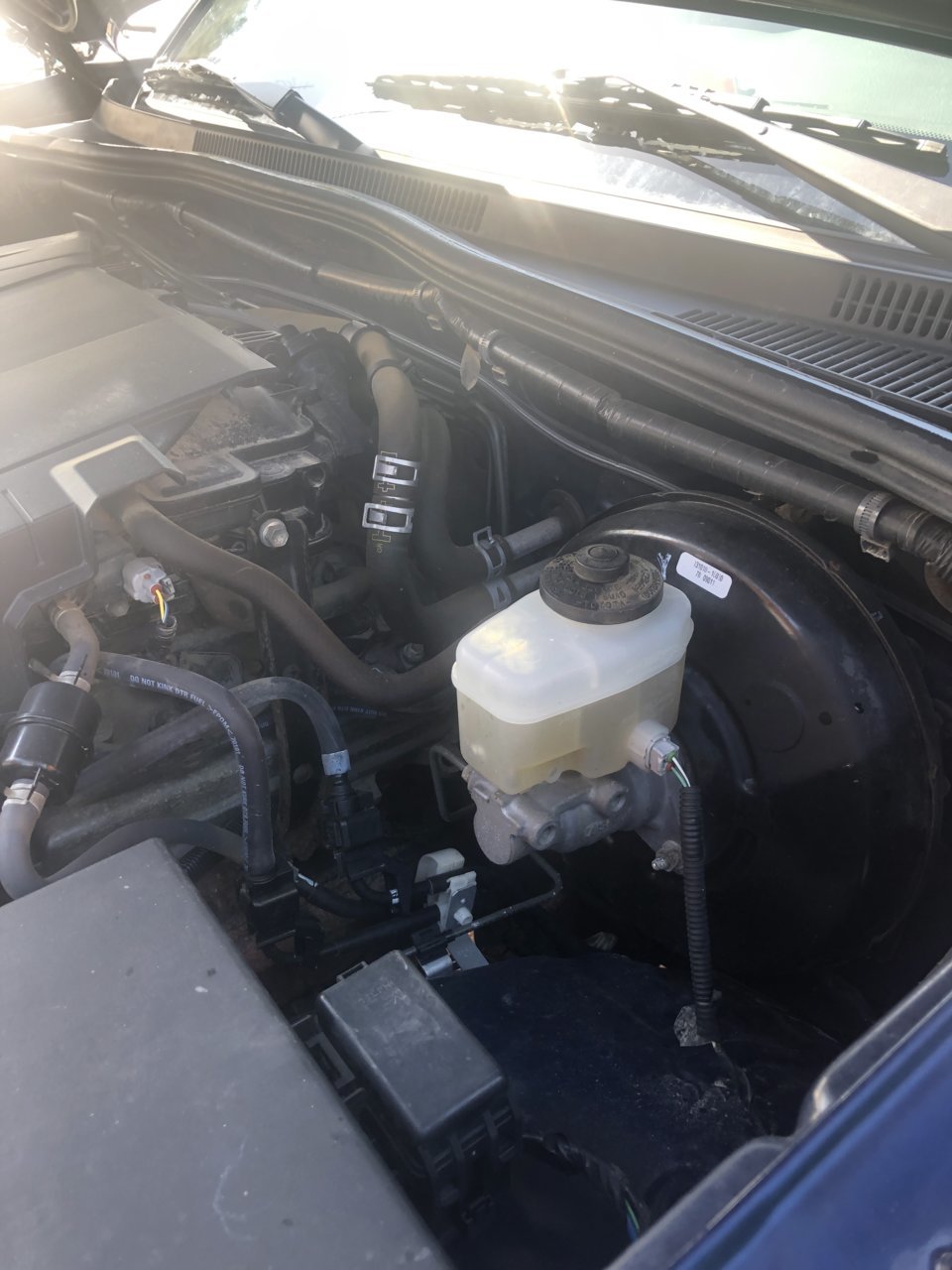

    Wow thanks for doing the research! Here’s a picture of my brake booster

    Doesn't matter if you see a light or not... there is no A-TRAC unless you have the hydraulic brake booster and 4 wheel spin sensors, wired together to the all important...

    A-TRAC was not even a standard TRD Off Road feature until the 2009 models. I know there were some earlier versions on the 4Runner and other models, perhaps a special option on Tacomas? They have to have the hydraulic brake booster and not the vacuum booster, that all other Tacoma models use.
